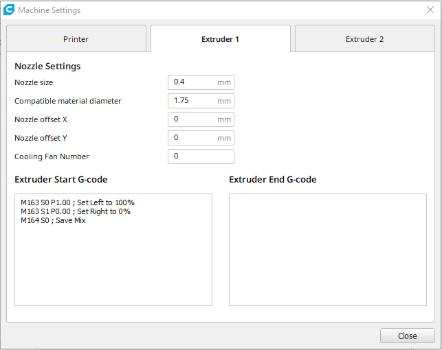

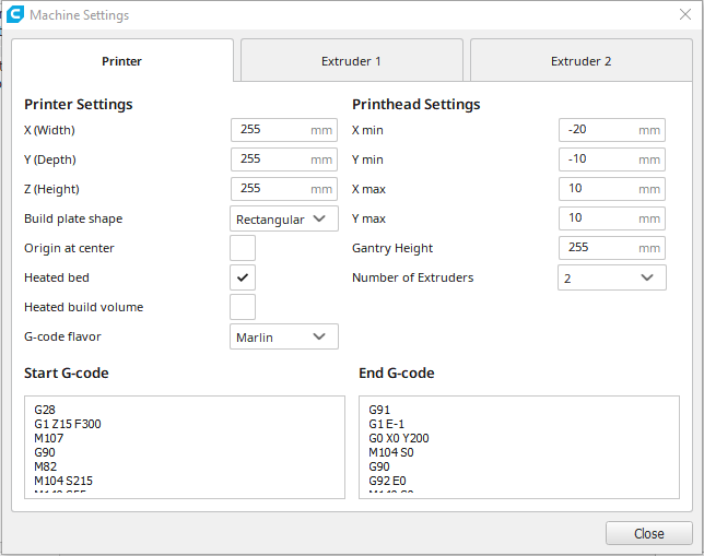

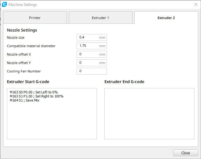

Here my settings in Cura :
- Printer
- Extruder 1
- Extruder 2

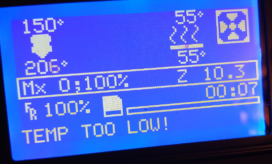

When printing a Gcode, only with extruder 2, or a dual print using extruder 2 (e.g. the traffic cone) the print stop with the message : : TEMP TOO LOW!
Error Extrud2.png (342.96 KiB) Viewed 7939 times
It seems that at this moment the Extruder 2 is at the setpoint 150°C, which is the Stand-by Temperature in Cura.
I'm gonna try to change it to 200°C on the 2 extruders, but is it the good solution?

Hello,
Answer to myself :
Yes, that's it. I have to increase the "Stand By Temperature".
