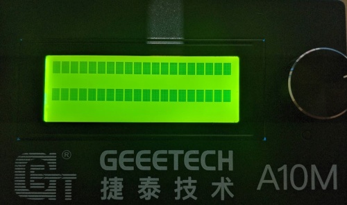

After some days of printing I’ve broke the bootloader of my A10M while playing with Marlin 2.0.1. Only two black lines on the display.
No flashing possible!

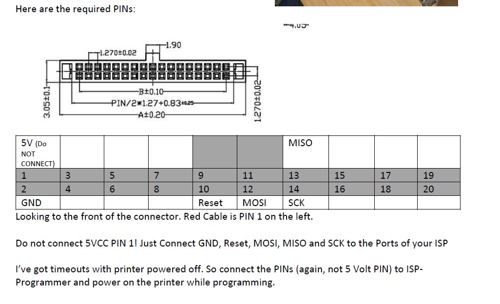

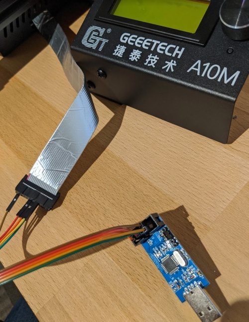

I’ve came to this forum and recognized that the cable between GT2650 Board V3.1 and Display is no longer 40 PIN FCC, it’s now 20 PIN IDC.
Easy to connect, but unknown Pinout. So, I’ve reverse engineered it.
See the Documentation I’ve created on how to flash Geetech GT2560 V3.1
