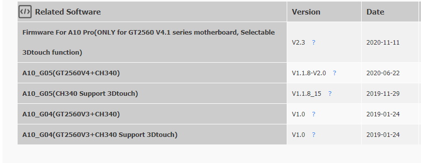

Hello,
but I´m also not sure which one?
Geeetech A10 firmware.PNG (17.51 KiB) Viewed 7520 times

What is the difference between:
1) A10_G05(GT2560V4+CH340) V1.1.8-V2.0 ? 2020-06-22
and
2) A10_G05(CH340 Support 3Dtouch) V1.1.8_15 ? 2019-11-29
It looks like that the 1) is newer as the 2). Does it play a any role? I do not want to downgrade the current version to the older one!
Second question - what about compiling it from the source from your github?
I can successfully compile the firmware from https://github.com/Geeetech3D/Prusa_I3_ ... 8_3DTtouch
Is the firmware up&running correctly? Can I deploy it? Which version is this finally (similar to the marked above as 2))?
It would be great if you can update your firmware page https://www.geeetech.com/download.html?download_id=30 with more consistent marked firmware versioning and indicate hardware version, please.

Hello, V4.1 series is suitable for GT2560V4.1 motherboard,
G05 is suitable for the main board of GT2560V4.0,
G04 is suitable for the motherboard of GT2560V3.1. You can see your printer's motherboard information in the on-screen menu. :D
