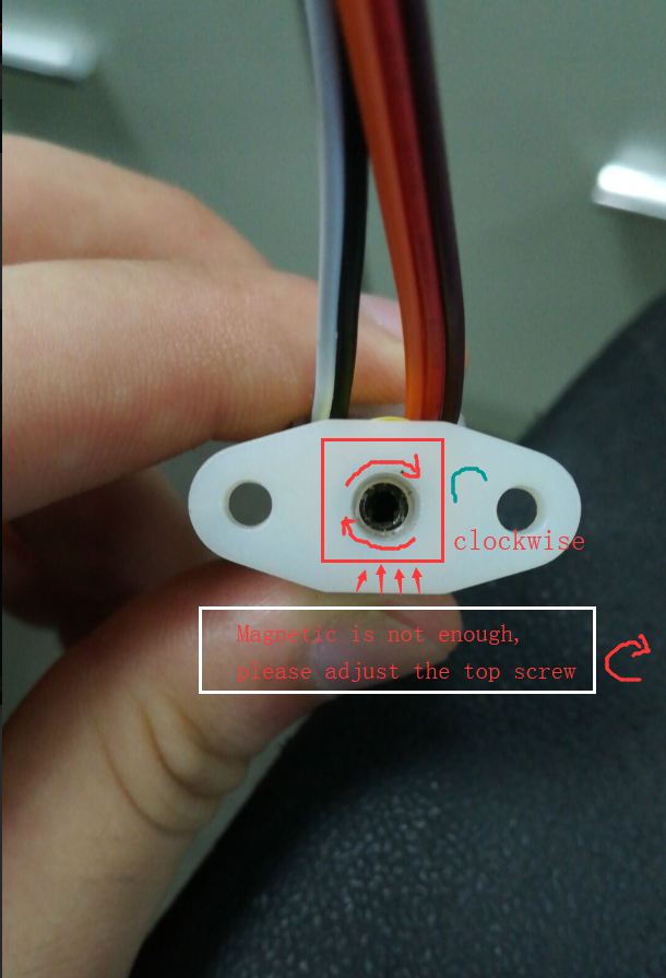

I then experienced difficulties with setting up the Z offset and the probe failing and entering alarm mode, this could happen after two operations or twelve operations, there was no logic to it.. After contacting my supplier they suggested adjusting the screw on the top.
I turned about half turn clockwise and it seems to work fine now, I left it on test mode for 15 minutes without failing.
I set Z offset by lowering Z until the extended probe just touched the bed and secured it, then measured the gap to extruder with a gap setting tool and worked out the offset.
