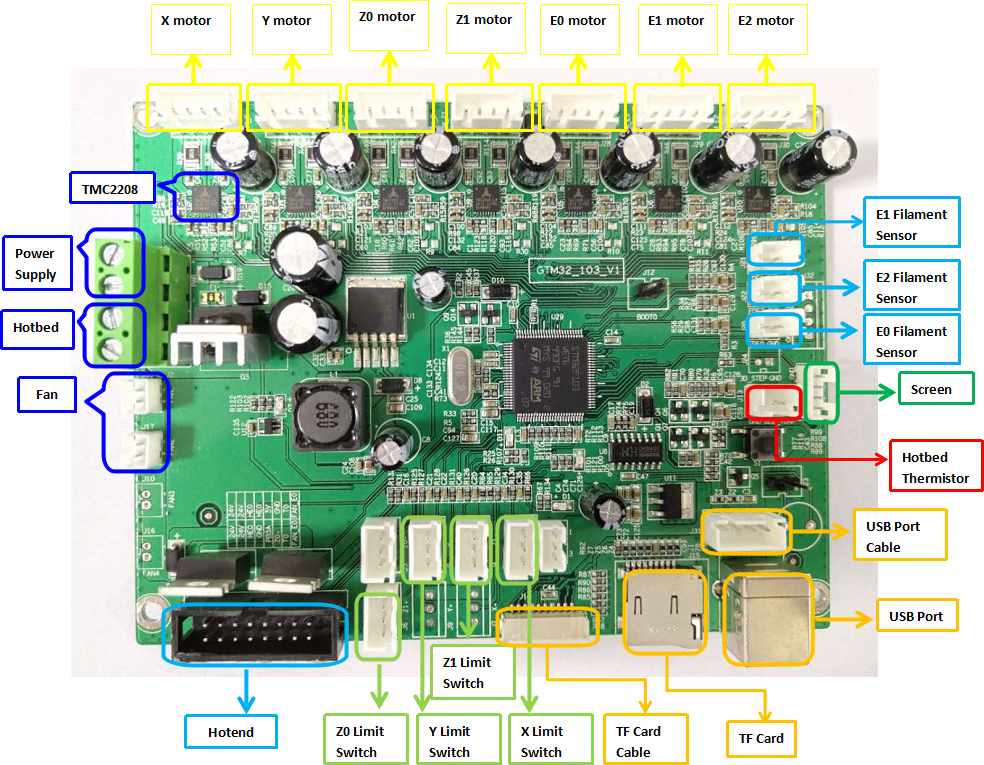

So I took my printer apart to do some changes and some of the PCB markings don't really match up with all of the cables labels. Is there any document that shows this info? I only found a old youtube video that is for old white motherboards, and this new green motherboard is way different.
Also, why would the hotend cable be hot-glued into the motherboard? That's weird. The good thing about Geeetech is how readily available replacement parts are, but the fact a cable was glued into a port is suspicious.
Here is a pic of the motherboard - Image , I am confused where the X_ES goes. I know the Y_ES is 100% correct. The Z0_ES and Z1_ES I think are correct even though the PCB labels don't make much sense. But the PCB label wouldn't make much sense at all for the X_ES to go in any of those so idk

Hello, this is the wiring diagram of the latest GTM32 motherboard.
