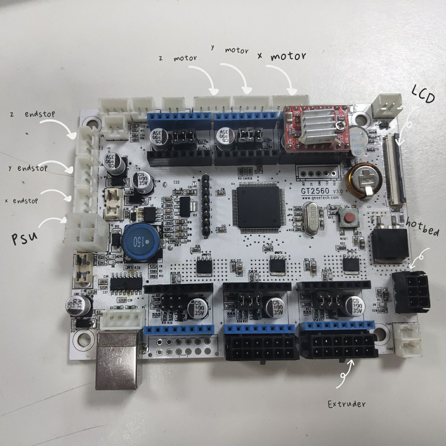

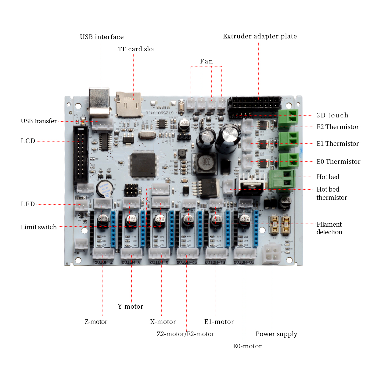

Hello, if you want to upgrade the motherboard, you need to replace a lot of parts:
Motherboard
screen
Screen cable
hotend cable
power cable
This is a comparison of motherboards, you can refer to it.
GT2560 V4.0主板接线图.jpg (621.65 KiB) Viewed 1984 times
