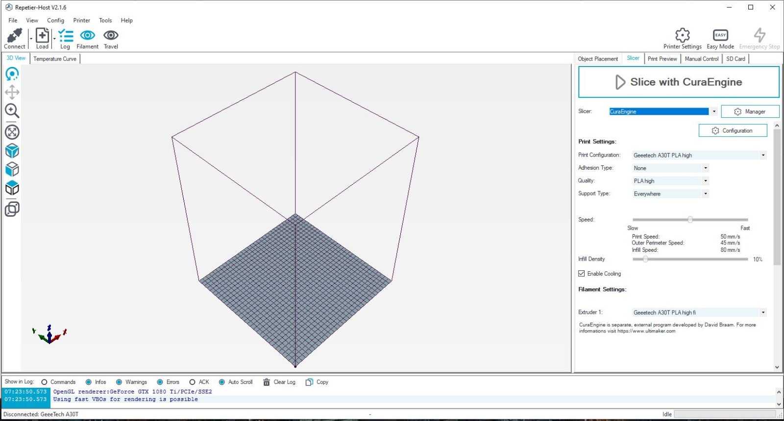

The A30t says the supported slicer is Repetier Host, and I loaded the config files... which I had to search for, being that it only give me the option of selecting 1 extruder with cura slicer, how do I add the other 2?
This is really holding up my prints, and need to get sorted so I can start printing..
Thanks.

Click on the “Configure” button of the slicer and after some seconds the slicer should start. Define your profiles and make sure to save them. After you finished the program, the host will scan the directories for new profiles and show them.
