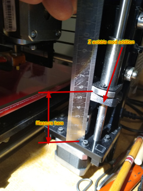

i use a spirit level to check
. A spirit level is of no use as the base of the printer may not be level. You need to measure each side and adjust each screw individually till the X-Axis is at the same height at both sides. I measure between the top of the Z motor plate and the bottom of the Z-Axis linear bearing bush., see picture.
As built, the two brass "nuts" which run up and down the M8 threaded rod (or T8 leadscrew if fitted) are locked at some fixed distance apart. If the threaded rods/leadscrews have any bends in them (and they probably will have!) the distance between them will change as the screws turn, this will cause binding, which in turn, will cause one or both of the Z-Axis motors to stall. This causes further binding between the nuts and screws and everything grinds to a halt.
A solution is to print off an anti Z-Axis wobble mod https://www.thingiverse.com/thing:1821976which, when fitted, allows the X-Axis to float on top of the "nuts" rather than being rigidly attached. any slight bends in the threaded rods/leadscrews no longer causes binding and motor stalls. Note that if the bearing rods aren't reasonably straight, you may get something similar happening as well!
Hope this helps!
