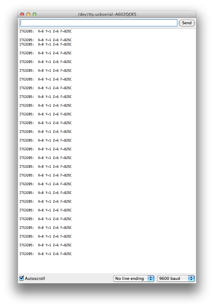

JacobSmith
- Posts: 3
- Joined: Tue Jul 01, 2014 10:09 pm
Re: 10dof sensor stick itg3200 gyro
I ran the code and only the values 8,1,6 are produced for x,y,z respectively as shown below in the attached screenshot. I have ran this code before. These values are constant regardless of the orientation of the imu. I appreciate the assistance in attempting to correct my problem. I will be expecting an expedited response from your end concerning obtaining a new unit.
- Screen Shot 2014-07-04 at 8.27.39 PM.png (127.08 KiB) Viewed 24297 times

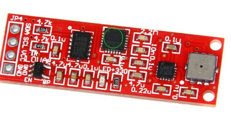

Dear friend,
I am so sorry about that.
I aplogize for bringing you so many inconvenience.
Please remember that I really want to and willing do my best to help you solve the problems.
Could you please try to re-weld the ITG chip? (I enclosed the picture)
Please be a little patient and have a try,Wish you can solve the problem out.
Appreciate your patience and understanding.
Best regards
Best regards
