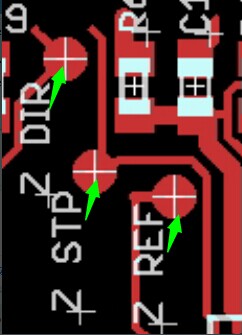

when the motor was working,you testing the following pins
the DIR and GND normal is 0-5V
the STP and GND normal is 0-2.2V
the RET and GND normal is 1.5V

Re: RAMBo malfunction on z axis motors
When I tested the areas you directed, I got the following results:
the DIR and GND was a dud, .002 volts
the STP and GND was very low, .025 volts
the RET and GND was almost normal 1.25~ volts
I upload the stepper firmware in this post.
you only need to connect 12V power supply and the axis motor.
you test the voltage between the pins again.
waiting your reply.Best regards.
DIR and GND fluctuated from .01 to 5.1 volts
STP and GND fluctuated from 1.1 to 2.55 volts
RET and GND was only .143 volts
