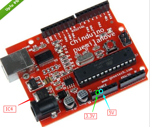

Dear friend,
Do you have a multimeter?
Please connect DC power supply to it and use the multimeter to test the output voltage of 5V and 3.3V.(You can check it according to the added picture)
If it can't shows the right voltage,you have to replce a new IC4.
Look forward to your early reply.

Re: Geeetech Chinduino Duemilanove dead
Seems IC4 dead, not outputting 5Vs. I don't have a IC4 with me, please send it soon.
