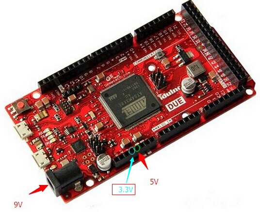

We can understand your felling,so let us do some deeper test to find the answer. Could you please power the board 9v DC or the slot 5v ,which we have marked in red,you can see diagram from the attachment ? Then you can test whether the 3.3v slot work well ,which we maked in blue. After you do this ,please tell us the result .Thank you for your understanding.

1. 9VDC
There is 8.84V on 5V pin
Threre is 3.34V on 3.3V pin
2. when connected 5V on 5Vpin
There is 5V on 5Vpin
There is 3.34V on 3.3.V pin
I hope, this will help you
Thank you for your help
Fedor
