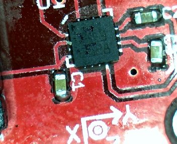

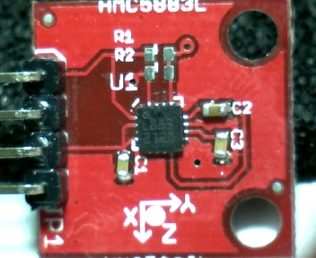

Please examine the attached photographs of the module. The HMC5883L is badly aligned on the board, also two of the capacitors.
The surface of the MHC5883L device appears to show heat damage from soldering.
The module is obviously defective.
I await a reply from technical support.

techsupport
Posts: 210
Joined: Sat Mar 03, 2012 2:32 pm
Re: HMC5883L magnetometer problem
Post by techsupport »
Hi friend,
Thanks for the details you provided.Sorry for late that I thought your request of replacement been received. ;)
we surely offer our customer's product replacement or refundment if it's defective.
