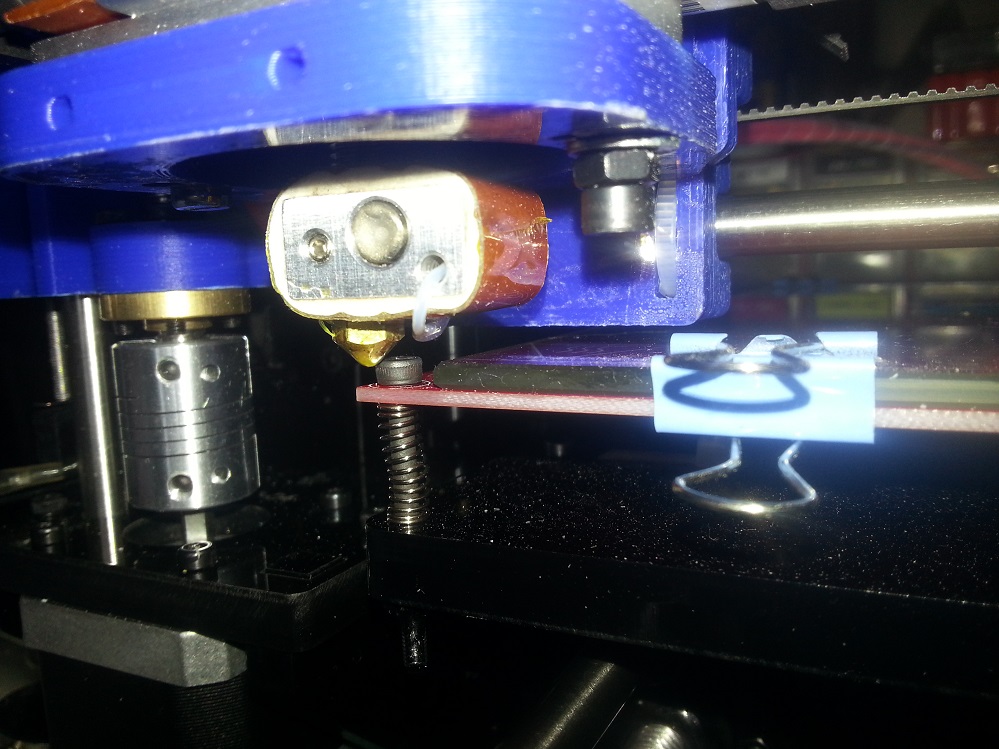

I'm quite happy of my I3 that prints quite nicely but a bit worried of the auto home position that seems to close to the screw (see the picture).
What is wrong ? The auto home position is related to the x and y-axes switches, how can I move the auto home position ?
Risky Auto Home position

- IMG_20150324_233919.jpg (214.41 KiB) Viewed 10055 times

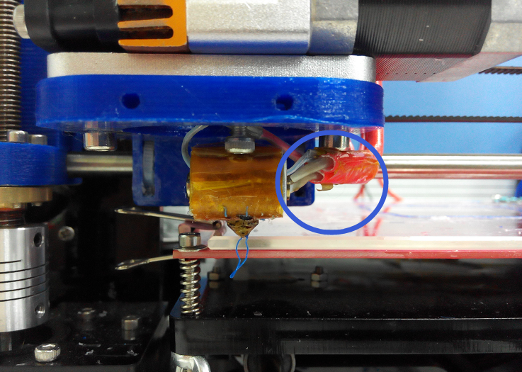

Hi, please look at the picture, can you see any difference from yours?
