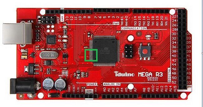

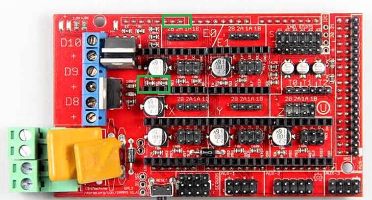

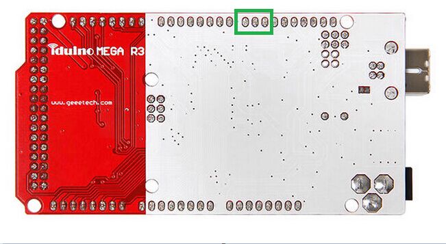

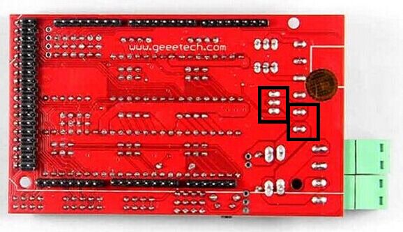

Please check if this parts, which are highlighted in the pictures, are short.
And confirm your hotted is connected to "+" and "-" of D8.

Are they short in size or are they touching each other (shorted circuit )
And yes the hot end connected to D8+ & -

Yes, I mean whether they touch each other.

Non of them are in touch with each other
