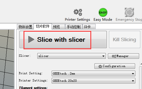

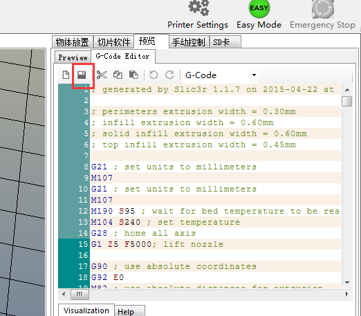

zhangxueyou
Posts: 1405
Re: Printer Stops in the middle of the printing
Post by zhangxueyou »
Open the stl file you want to print. Click "Slicer with slicer". Then click the "Save" icon to save the file as g-code file.
Actually, even you use Repetier to print the model, the job the printer implements is g-code file too.

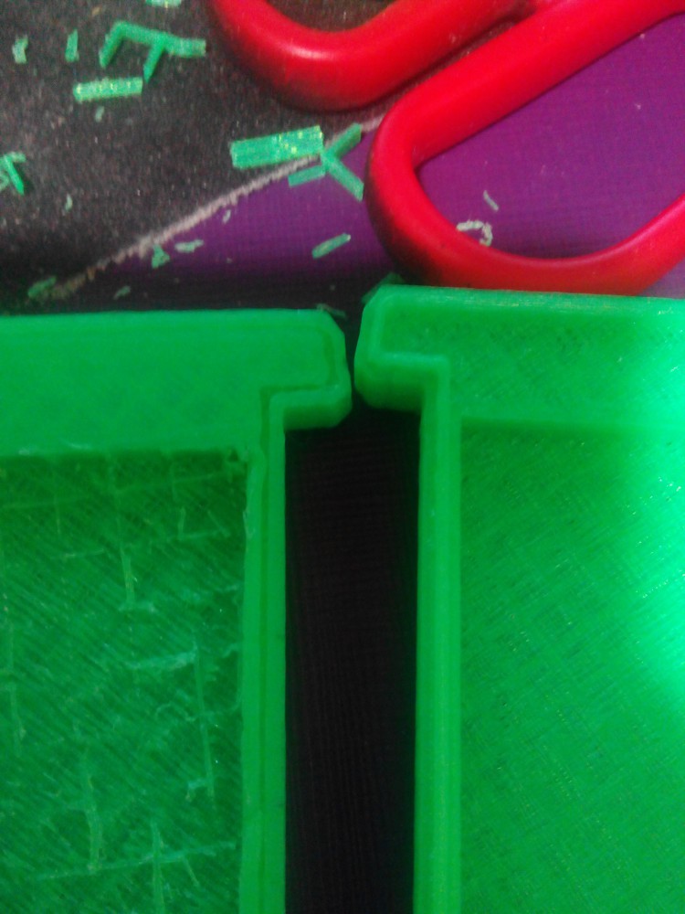

Finally i achieved to print big pieces from the SD card, is a bit annoying, but it works. Now im having another problem with the print quality. This to pieces are supposed to fit together, but the material seem to deform for some reason
zhangxueyou
Posts: 1405
Maybe it's slicer issue, you can try to optimize slicer .
