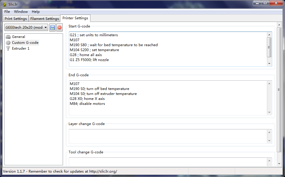

I manage to print calibration cube and box. Since quality was terrible I started trouble shooting the settings on the original software. Repetier/slic3r downloaded from the link ay the end of assembly instruction .pdf file. After what I thought it was just making corrections or adjustments to slic3r and repetier like getting higher/proper ABS temps for bed and extruder, filament thickness, adding the second extruder to the software, etc. the printer just started to behave incorrectly. i.e. starting printing without heating the extruder and the bed, not extruding enough filament, etc. after a while I decided I must have change a setting I should not have. So I deleted everything and re installed all. To my surprise it didn't fix all the problems. Now the printer preheats the extruder but not the bed. Actually the bed never heats up. Only manually. so before printing I preheat the bed then I start printing which starts heating the hot end the when it starts printing I turn on the bed heater manually again. It will not stay on after a click on play. So I wonder what could be wrong and I ask for help how to fix it. Also I would like to know if it is software or firmware problems.

If you want the printer heat automatically before printing, you should add some codes in Slicer like this:

Thank you for your response.
Yes this solve the problem and found a couple more.
1 I added this code to start code in slic3r but it does not add it to G-code what I slice any other .stl. Is this normal.

Chupacabra wrote:Thank you for your response.
2 When I load a new .stl removing the previous one loaded. When I slice it it generated g code from the previous .stl even if I have deleted it. I have to exit repetier and run it again.
I am new to 3d printer, so I don't know if these are known issues. If they are I kindly ask you send me to the right place to find answers if I'm not in the right one... ;)
This is my first printer and It has been a very exiting learning experience.
Thank you again for your help
Mayebe it's software issue.
Generally, when you add these codes in slic3r, this codes will turn up at the beginning of g-code.
After you remove the former stl file and add new stl file, and slice with slicer, all the g-code will be new. You don't have to exit Repetier and run it again.
