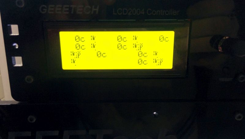

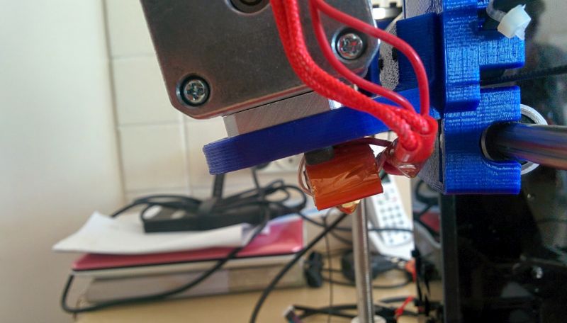

I have a same simptoms with smoke. Tested the resistance of the bed and get 1.0 ohm. Is this ok? This is a new Geeetech Pursa i3, just got before few days from eBay.
Also, I have:
1. LCD issue with garabage characters.
2. Extruder bracket P4 part bend down.
3. After issue with the smoke bed MOSFET, it seems that Sanguinololu bed MOSFET is burn out.
On Sanguinololu, all of axies is moving, extruder filament motor is moving and the heating of the extruder is ok.
Filament type used is ABS with default values of temperature.
Hot bed temp was rised to quick, less than 1 minute up to 90 degrees.
Please note, this is just assambled new printer. Less then 2 hours of working.
