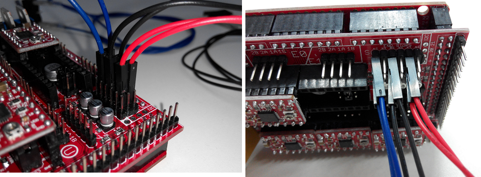

where should I connect a switch for Auto bed leveling?
Im using rampas 1.4
zhangxueyou
Posts: 1405
Re: Auto bed leveling wiring
Post by zhangxueyou »
If you are using Rostock Delta, it should be connected to Z-MIN slot, it is at the position of red wires. And endstops should be connected to X-MAX,Y-MAX,Z-MAX.
In the picture, the slots which have been plugged with wires are X-MIN,Y-MIN,Z-MIN.
