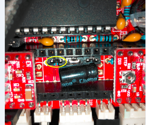

You need to plug only 1 jumper cap for each DRV8825.
jumper cap 8825.png (341.66 KiB) Viewed 9107 times

Gotcha, I'll give that a try and let you know anything else. Thank you so much for helping by the way! :D
