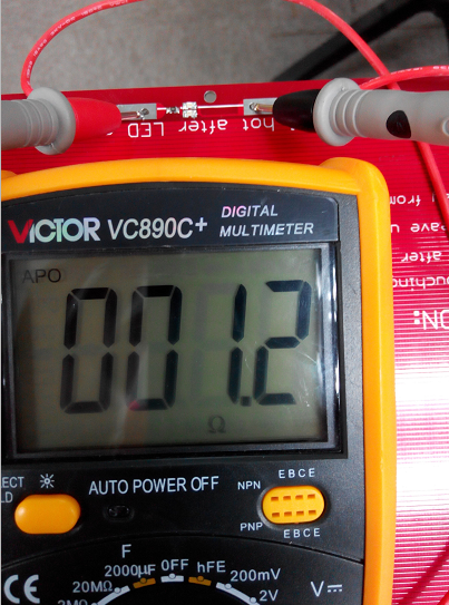

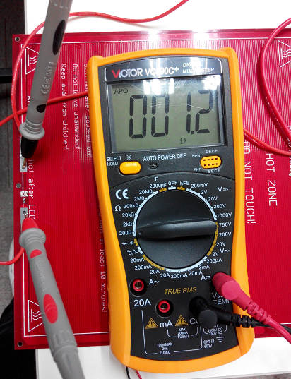

Normally, when heating the bed, the temperature of MOSFET will be very high even you have a fan.
How did you test the resistance of the bed? Is it like this:
test hot bed resistance1.png (395.11 KiB) Viewed 8262 times
test hot bed resistance.png (355.08 KiB) Viewed 8262 times

Yes i did it exactly that way, i saw your pics in an other topic.
I read out between 0.2 and 0.25Ohm. I can make a picture if you want, but at the moment i have a 12+ hours print job so i can do it later on...

If it is the value you get after you unplug the heating wires, this hot bed is abnormal. Please contact the customer service, let them re-send you a good one.
