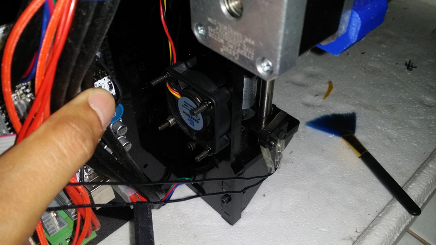

Picture attached. I tried printing another wide object, and it warped again on the side near the fan, even though it was far from the corner or the side of the heatbed.
The bed is leveled and I'm using kapton tape with hairspray. All prints are fine except for anything near that side. The skirt also sticks very well even on that side, but the print warps after some time of printing.

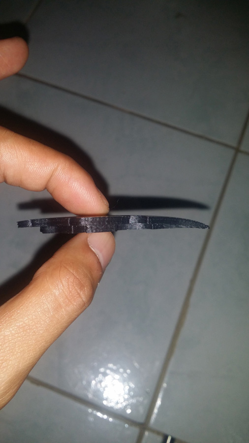

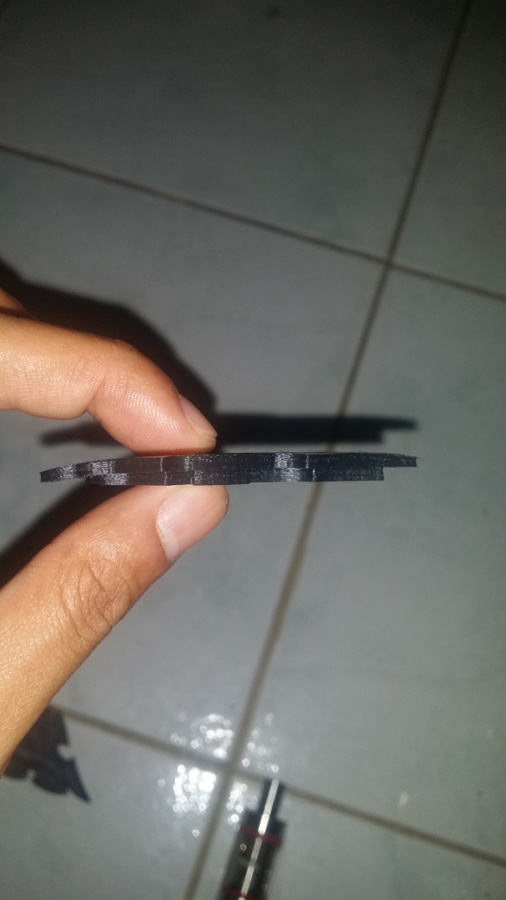

I did another try with multiple objects and I just found out that the PCB wasn't causing the problem. If the print takes too long, around more than 2 hours, the print on the left side (near PCB) will lose traction with the bed and warp. It only happens to that part of the bed though.
I printed 6 objects and the object on the corner of the bed warped. (1st print) (print time: ~4 hours)
I then printed only a single object on that corner of the bed, and the print was ok (print time: ~45 minutes)
I then printed another set of 6 objects same locations as the 1st print and the corner object was again warped (2nd print) (print time: ~4 hours)
All prints had good adhesion from the beginning until a few hours later, the parts started to lose traction with the bed.
I also wiped the bed clean with acetone, and applied a new layer of hairspray in between the prints.
I also printed another wide object, and traction was good at the beginning, but after 1 hour, the same side of the bed lost traction and warped that I had to cancel the print.
- 2nd print
- 2nd_print.jpg (77.87 KiB) Viewed 9846 times
- 1st print
- 1st_print.jpg (87.38 KiB) Viewed 9846 times

I found the problem and was able to fix it.
I checked some pictures of the MK8 and saw that my fan was installed incorrectly, it had the fan blowing out instead of into the extruder.
