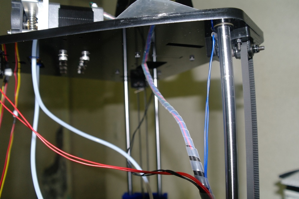

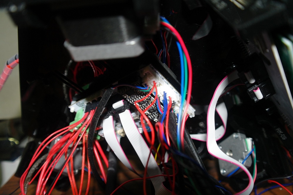

I'm sure that the wires are connected the same as the diagram, I already triple checked them, here are some photos to prove it.
Also i uploaded a video to youtube showing the problem, here is the link: https://youtu.be/eB63nH6C1Bc
Here is a picture of the board:
Connections
Connections
Here is a picture of the limit switches:
Switches
Switches
