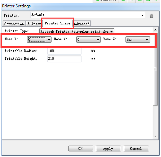

please check home coordinate you set up in repetier host.and did you connect endstop wires to correct connector?moriartynz wrote:Hi people,
I have the G2S Rostock kit, which is now assembled per the instructions. When trying to set up the printer, I have downloaded the firmware and uploaded this to the controller ( http://www.geeetech.com/wiki/index.php/ ... d_firmware) . I have set up Repetier and following the set up instructions, I get to the step about pressing the home button in manual control ( http://www.geeetech.com/wiki/index.php/ ... he_printer ). When pressed, the X, Y, Z all smoothly move down until the hot end nozzles crash into the bed. Please let me know how to fix this. Thanks.
then please check endstops whether it is loose ,or not in a good contack.

Hello, Thanks for the reply.
The set up is exactly as you have shown. The endstops are correctly set up. They are not being used as the printer is crashing down to the bed, not heading up to the X, Y, Z endstops.
