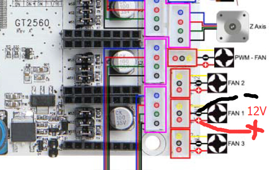

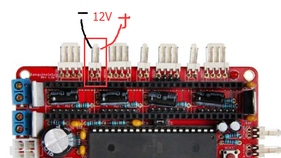

Did you plug it in the right place? If so, what's the voltage of the fan slot?

But try to measure the voltage here first(GT2560 and sanguinololu):

I tried with a voltmeter : it stays at 0.0...
Is that a problem of the card ? (it's a GT2560)

Can you move the motors and other parts? If you can, it can't be 0V. So did you use the 20V DC range?
