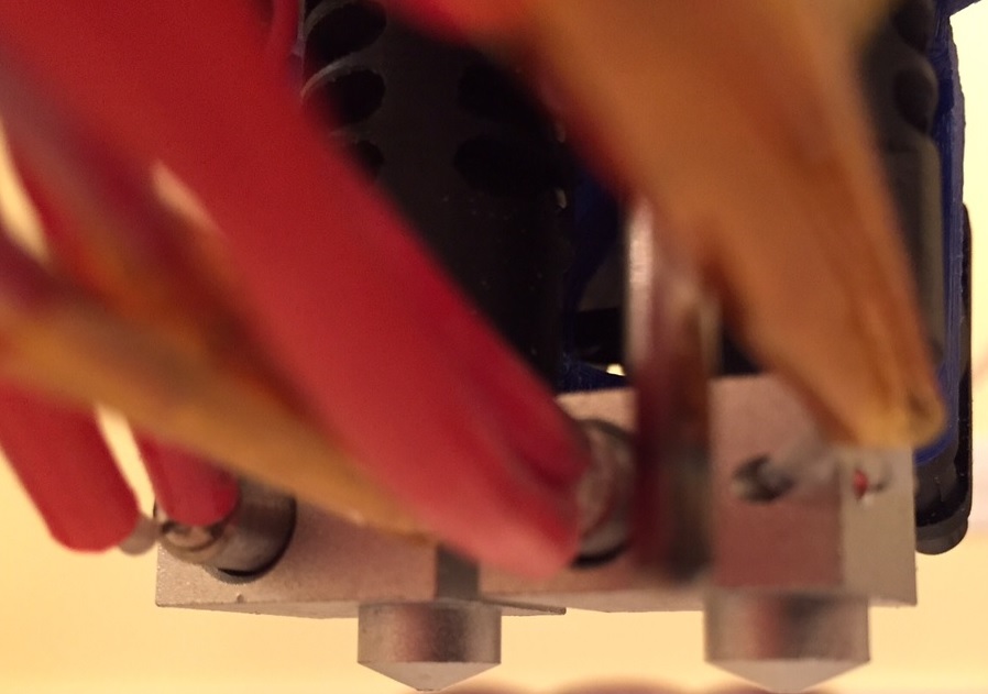

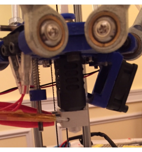

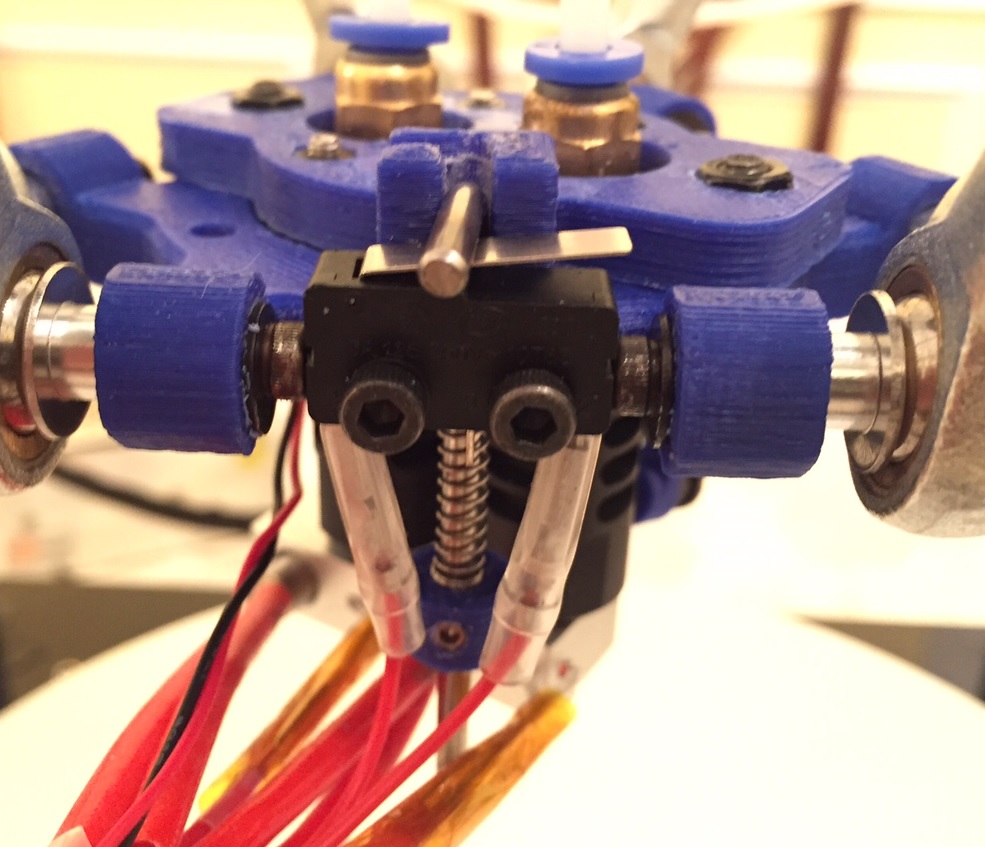

I am nearly complete with my assembly, but I noticed a potential problem. It appear that the Auto Leveling Probe does not extend down below the hotend. It looks like the hotend nozzle will hit the bed before the probe. Did I assemble something wrong or is the probe too short? See the attached pictures.

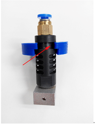

hi,guys,you forgot to put down the probe when auto leveling,when finish auto leveling ,please remember to hook up it.Referring to the link:http://www.geeetech.com/wiki/index.php/ ... o-leveling

As shown in the picture the probe is down. and it still does not extend down below the nozzle. Did I assemble something wrong or is the probe too short?

smithti8 wrote:As shown in the picture the probe is down. and it still does not extend down below the nozzle. Did I assemble something wrong or is the probe too short?
maybe you have inversed the the the half bracket,look at the picture,this is the right assembly.

I have the same problem, was it was it the case of an "inversed half bracket"? Or was it something else before i go ahead and disassemble :)
Thanks
Mark
Posts: 1553
Re: Rostock mini G2s Auto Leveling Probe
Post by Mark »
yes, once I ran into this problem too.
ianbn
Posts: 8
Joined: Sun Sep 06, 2015 4:18 am
Post by ianbn »
Did you solve it by tuning around the half bracket?
Mark
Posts: 1553
Post by Mark »
It shoul be assembled as the picture shows, I reassembled it before.
