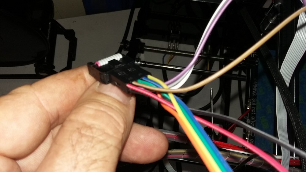

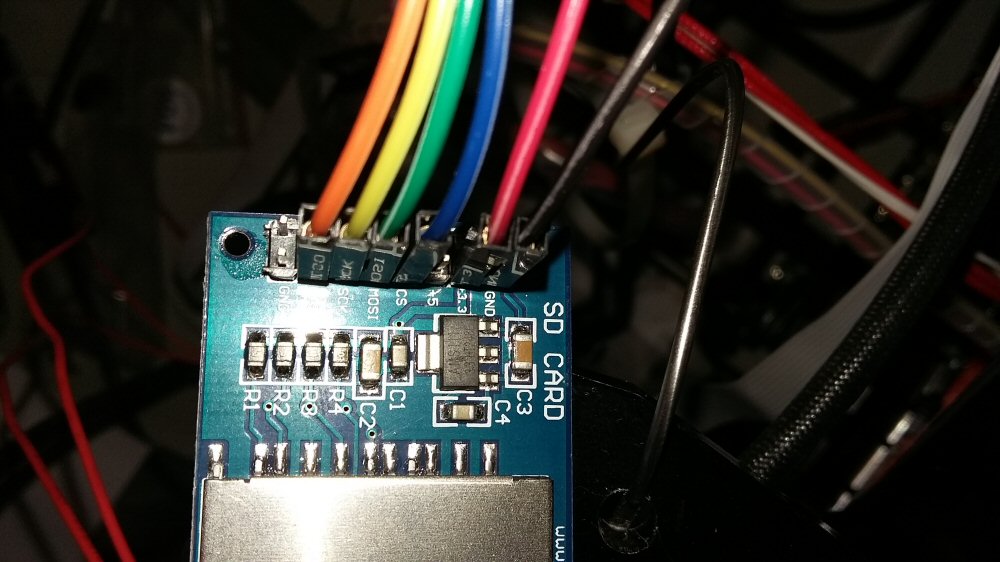

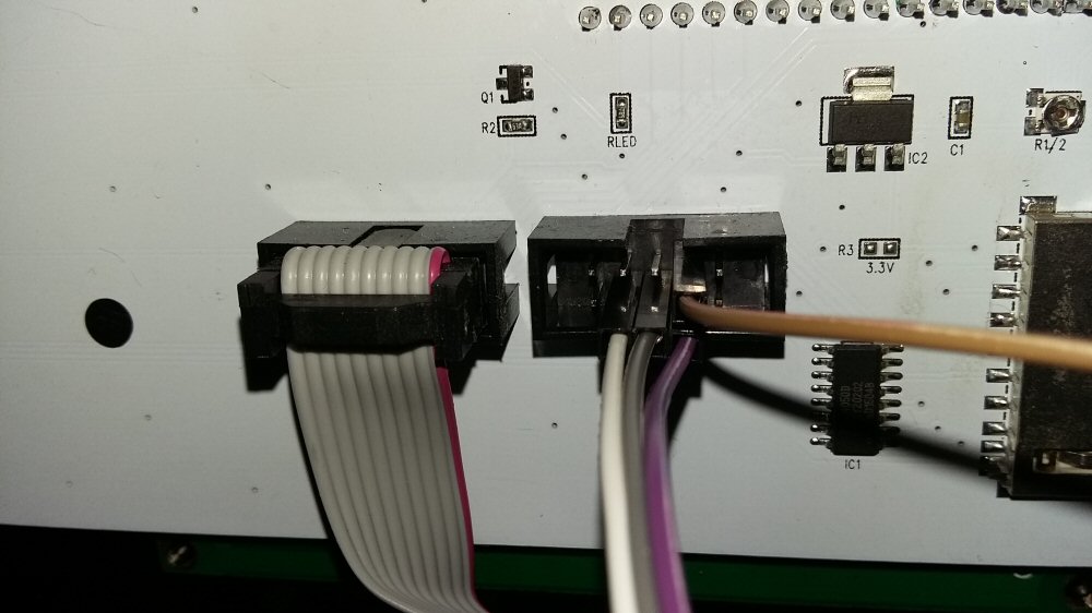

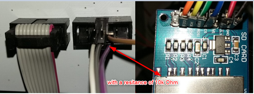

Hello,
Thank you for your work. It works fine with Marlin 1.1.8 on my GeeeTECH i3 Pro W (GT2560 rev A + with LCD2004 Yellow) and my CTC Prusa i3 (GT2560 rev A with LCD2004 Rev3 Blue)
To operate the sd card insertion and removal detection, connector 7 (CMD) must be used on the connector of the incoming web of the GT2560 with a 10K Ohm resistor on a non-wired switch on the arduino module. (to see the photo).
https://1drv.ms/u/s!AuNBpmXL1y0Rg89SEHyc9MGHv6T8lw
Thank you and have a nice day: o)

Re: Extend SDcard Reader
Ooops !!! Photo ;o)
- connexion sd card detection.png (537.01 KiB) Viewed 9115 times
