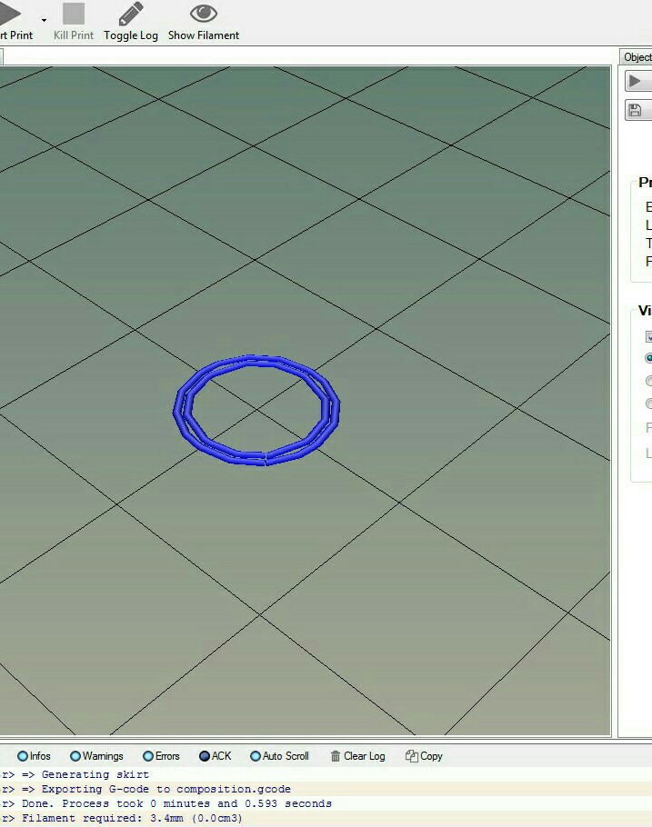

I used my meter and realized that it was set for the 220v input when I only have 110v. It is functioning now and all motors are moving and everything seems to heat up correctly, but I have run into 2 more problems preventing me from making my first print. Firstly, in Rep, when I slice the 1cm test cube (or any other model), it does not come out properly. It keeps coming out as a single layer ring. (I added a picture of the sliced test cube). I made sure I changed all the settings as instructed and all the slicer settings were set to the "normal" configuration that I loaded.
Secondly, if I try to print the ring, the printer goes through the motion of the ring, but no plastic comes out. I did make sure to manually feed the plastic through to make sure it isn't blocked up or anything.
I'm not sure what to do about either of these issues.

how could it be...then how about reinstall the repetier host? or use the previous or later version?
And the ring, it's too small the extruder needs a minimum length to extrude filament out of the nozzle, try to print a larger object.
