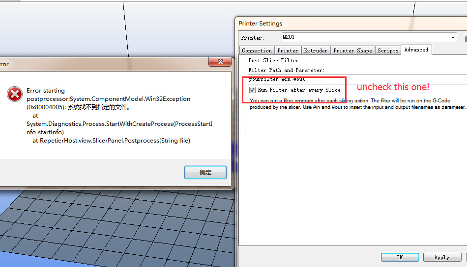

Hi ,very new to 3d printing, just purchased a geeetech prusa i3 aluminium kit, now assembled,but when slicing,I get an error message :- error starting postprocessorSystem.ComponentModel.Win 32Exception(0x80004005); the system cannot find the file specified at System.Diagnostics.process.startWithCreateProcess(ProcessStartinfostartinfo)
at System.Diagnostics.Process.Start()
at RepetierHost.view.slicerPanel.Postprocess(String file)
Can someone please explain what this is allabout,is it serious,how to fixit. HEEEELP

you need to uncheck this option here:

Thanks a million for that ,just did a dry run and NO MESSAGE. that's one problem out of the way
Thanks again. coldoug
