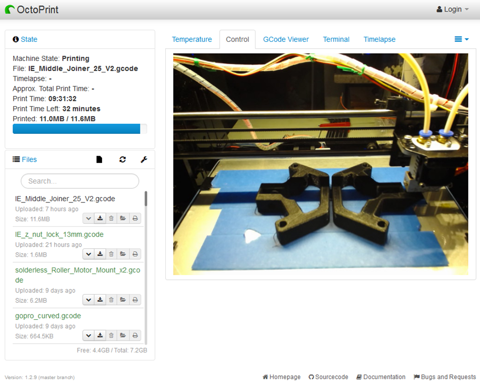

Attached is a screenshot of the Octopi html page (accessed from the internet) while printing parts of my future MPCNC
I am not at home now but I will have a look at my configuration for octopi and I tell you.
