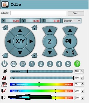

I think i didn't explaine myself good enough. I am capable of heating on the nozzle, but only if I go into repetier-host manual controls and turn on nozzle two, see attachments. but when I run a program it tries too heat up nozzle 1 which does not work
look at nozzle seting lower left corner

Simen_Sorebo wrote:I think i didn't explaine myself good enough. I am capable of heating on the nozzle, but only if I go into repetier-host manual controls and turn on nozzle two, see attachments. but when I run a program it tries too heat up nozzle 1 which does not work
did you choose t extruders in printer setting and also please check your slicing, you need to set for two extruders too
