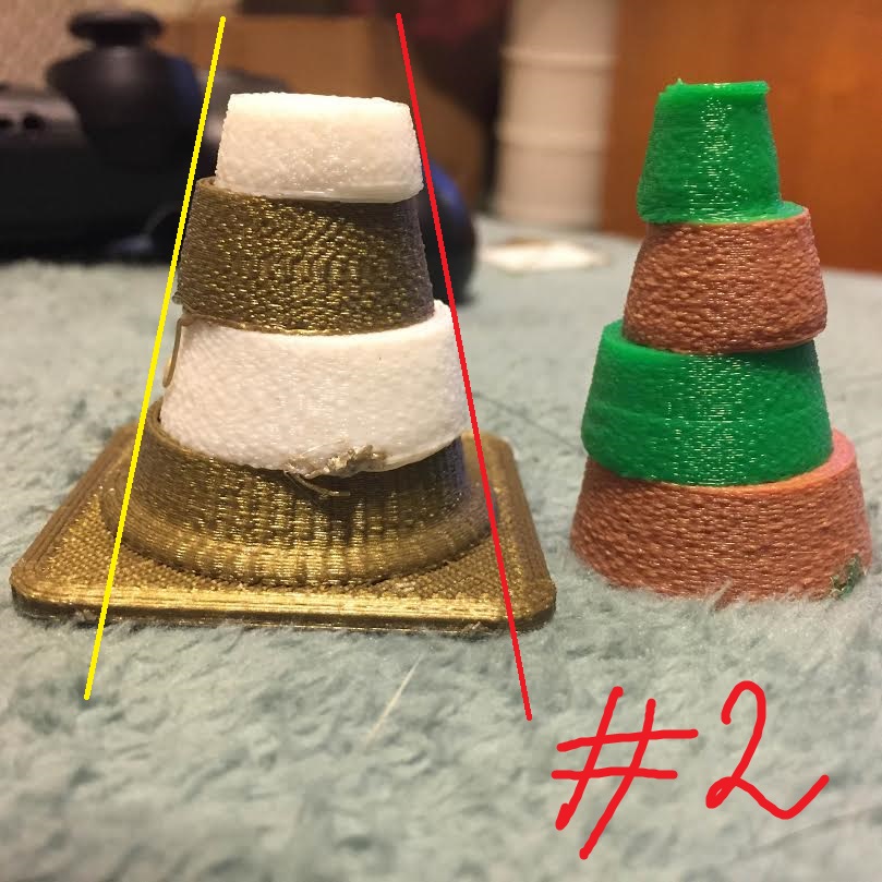

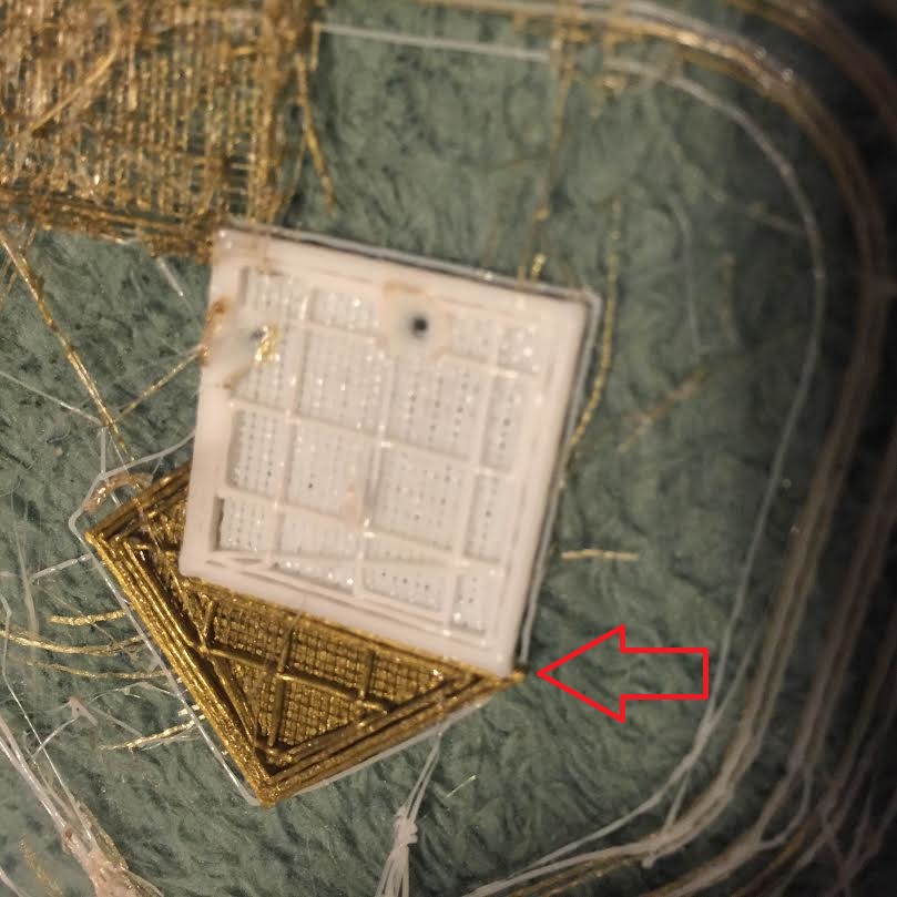

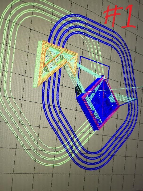

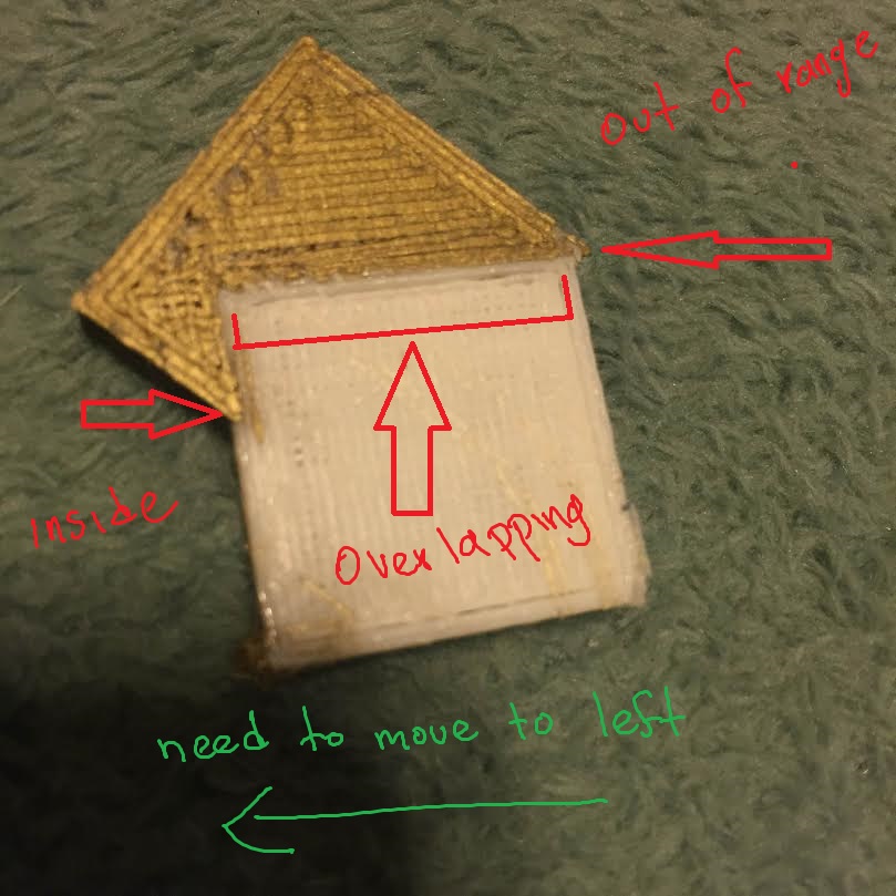

Hi geeetech team, i have a problem with my g2s, after i upgraded to all metal parts i was able to print but there is problem with the extruders offset i am not able to fish no matter what settings i change in repetier or the firmware. changing the extruder offset in repetier to a very high number and the print is not effected at all as you can see in picture #1. i also changed extruder offset in firmware and the extruders just go to a higher position causing the print to be on empty space. i have read many past posts and i did not find any information for this problem. you can see in image #2 that my layers have over two mm in offset. i also looked in many places in the firmware and i can not find where i can change the position of the extudrers. can anyone tell me where i can fix this problem in the firmware because the setting in repetier do not have effect on the print. see pictures 3 and 4. thanks for the help.
