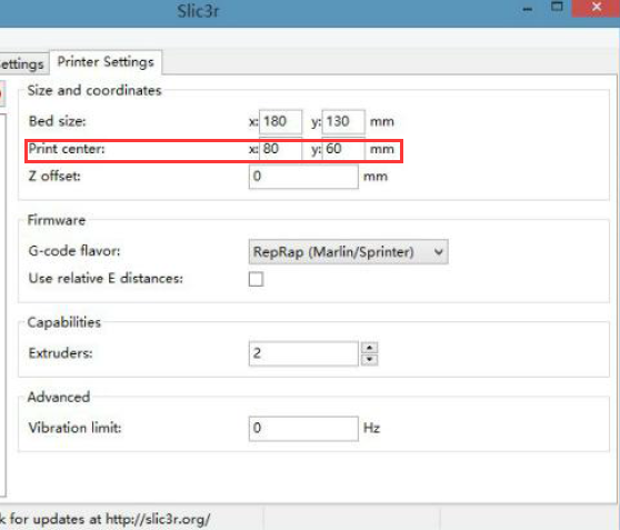

Hi,Trevor
There is a setting in "printing setting" which you can set your printer's beginning center.Though my software is "slic3r",i guess there is a similar setting in "Cura",wish that will work.Have a look at the pic below:
