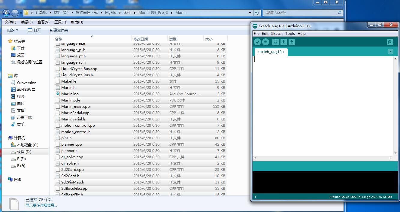

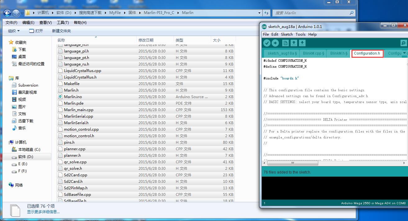

yes i have seen that but on the arduino sceen i dont get the tabs for for the configuration h or any other tabs below file edit sketch tools help bar not sure whats going
Re: y axis question
andy65 wrote:yes i have seen that but on the arduino sceen i dont get the tabs for for the configuration h or any other tabs below file edit sketch tools help bar not sure whats going
I guess you didn't open the firmware successfully in Arduino,you can follow my steps:
1.Download the firmware for your printer from here:
http://www.geeetech.com/forum/viewtopic ... 20&t=17046
2.Open the firmware,then "Ctrl+A" to select all the files:
3.Drag all the file to Arduino,then you'll see configuration.h:
