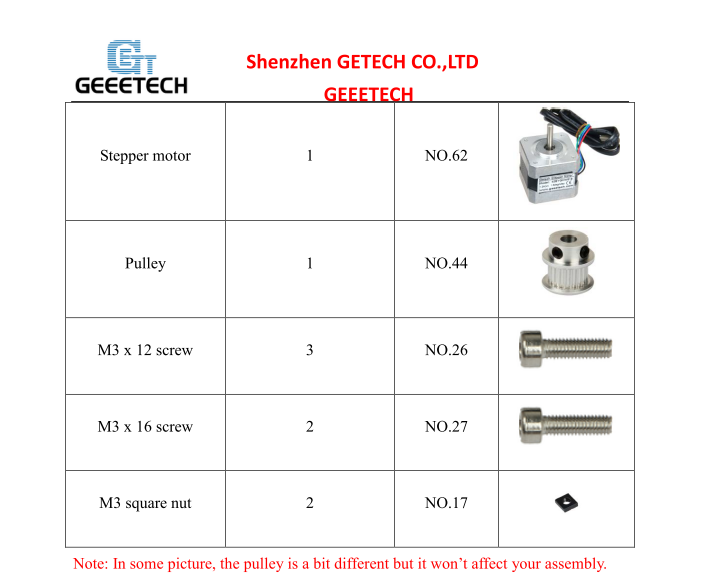

I'm having an issue with the asssembly of the first nema 17 on the bed side, on the pages 19 and 20 of the manual instrution of the i3 acrylic pro B it say the mount the acrylic part A13 on the motor and later mount it on the platform with M3 x16 screw.
The problem is, there's 155mm betwen the acrylic parts and the screw is only 16mm so its impossible to assembly correctly
Here's a picture of the problem:
http://i64.tinypic.com/2upwi91.jpg
Can you tell me what's happening?

Which part is 155mm?
In the instructions you can see you need to use M3X20 screws not M3X16.

15.5mm sorry, forgot the ","
And finnally that's the problem...instructions are wrong...
It clearly say M3 x16 on the requierements on the page 17, and later in page 18 like you said it says M3x 20...
Re: i3 Acrylic pro B; impossible to mount motor on bed
Yep,i found it too.It should be M3*16.
