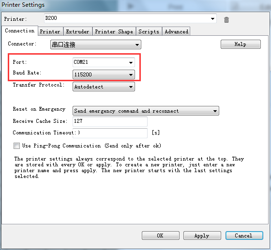

You should check if the two settings are right: You can find the corresonding COM port in Device Manager,and the Baud Rate for ProA is 250000.

baud rate is correct - 250000, com port as well and Repetier shows the green connected button.
Cables are checked, USB cable has been replaced just in case,
I can connect via arduino sketch tool and uploade the firmware.
I can move the axis from the control box, but it doesn't react from Repetier in any way...
