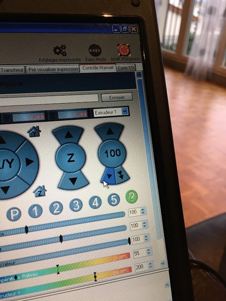

I bought a GEEETech acrylic i3 pro B and I have exactly the same problem.
I tried with the Z axis motor, with the z axis cable, same problem.
Check the pololu, check the power unit => same problem.
I tried every firmware for the GT2560 in this forum, same problem.
When I change the step/mm for the extruder, same problem.
If I want extrude 100mm (repetier or with the LCD) I only have 14mm :evil:

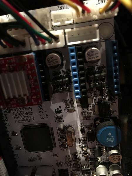

Hi,Philippe

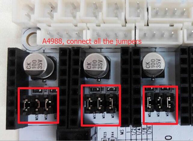

1.Did you check the subdivision?
2.Have you tried swapping the driver A4988 with other motor's?
3.Theoretically,you can modify the step/mm in "Control-Motion" and "Control->Store Memory",then the modifying will come into effect next time.

subdivision checked
subdivision checked
driver A4988 swapped

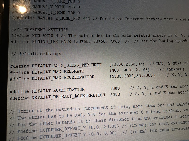

step in marlin
step in marlin
step in repetier
step in repetier
next try ?
next try ?
14mm for 100mm asked :(
same try with the new firmware received by mail and same result

Thank you William.. I did all things you say but its still happend the same thing, When I setting on the Repetier to extrude 100mm/min It extrude some 10mm/min and when I send it to print the motor just doesn't move. I change at frimware E0 with E1 and the change it works, but the problem persist!! Im really lost and sourprised ... I change the motor with other motor and its happend the same thing.

Always the same problem, I think the extruder part of my board is dead.
I swapped the motor, the wires, everything and all of this work fine in the X for exemple, the only answer is dead board.
:evil: :evil: :evil:
