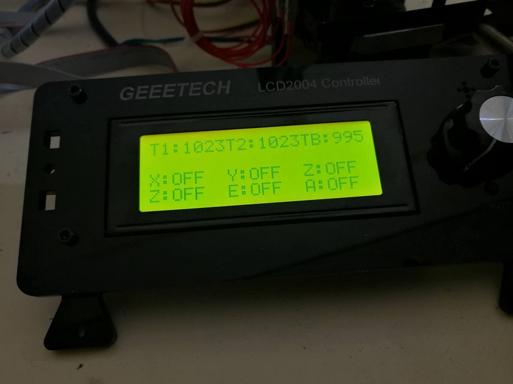

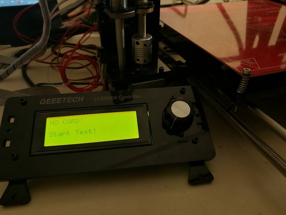

i buy a I3 pro B few month ago. and i have some trouble with it.
when i power on the printer, lcd screen display the following message :
nothing happend when i turn button,
if i clic on the button, the Y motor move the hotbed from back to front and never stop.
this appear on screen when Y axe move.
is someone can help me please ?

and an other detail
when i connect the printer to the slicer (repetierhost) i can't move axes with manual mode.
and i haven't neither the extrudor nor the hotend temperature
Re: Trouble with I3 pro B.
You can try re-flashing the firmware for you ProB.
Download the firmware:
http://www.geeetech.com/forum/download/file.php?id=2819
Refer it to upload the firmware:
http://www.geeetech.com/forum/viewtopic ... 13&t=17181
