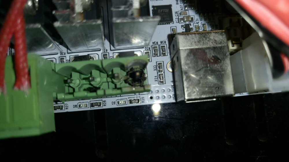

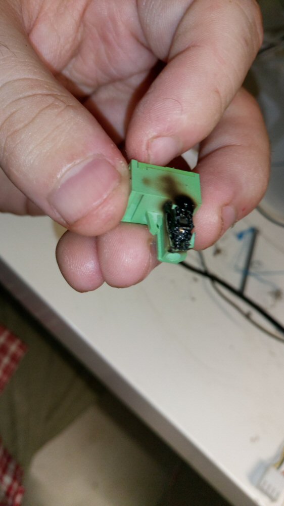

Hi there
My control board has failed it is a GTx2560 board with my Geeetech Prus I3 x brought on 30 of may 2016
what has happened is the connection to the hotbed on the board has burnt out and has failed. i have attached photos. it suddenly happened during a print where the bed was set to 70c.
before you ask me too. i don't know how to program/change its firmware, etc. And honestly i feel if the board keeps being used there's a risk or further damage/fire risk.
regards
Jeremy

I guess you can buy another green connector(the same style) to solder on the board if you have the skill,or you can have it repaired in local store if you can't solder it by yourself.

I guess you can get the connector on Ebay or Amazon...
And the problem is not that serious,the connector was burnt because of the high current of heatbed(maybe heat up to a too high temperature in use).
I guess the board will work normally except the heating of heatbed now if you turn on the power.
