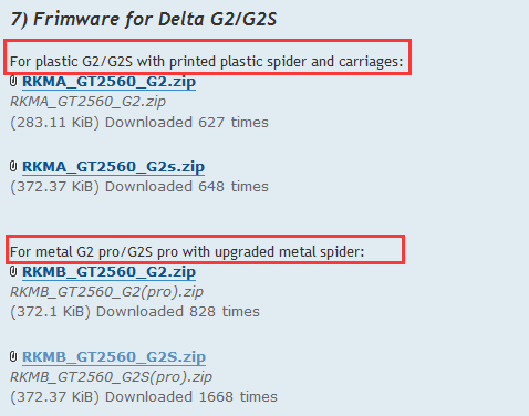

Did you download the right firmware for G2s in this post?And you have a metal or plastic version?

My Geeetech is G2s Pro. I've downloaded RKMB_GT2560_G2S file.
I want to retry to redownload it.

Thank you Cup! After re-downloaded your suggested file RKMB_GT2560_G2S.zip,
made changes in configuration.h as suggested in http://www.geeetech.com/wiki/index.php/ ... k_mini_G2s
with more attention then first time and now extruders switching WORKS CORRECTLY ON THE ASSIGNED Z LEVEL!
In the "old" configuration.h file I forgot to set Z_MIN_ENDSTOP_INVERTING = false.
It's the only one parameter I've found "out of place".
