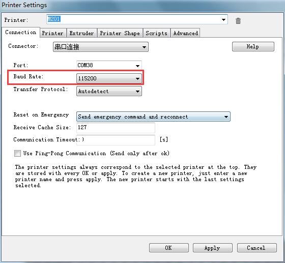

I suppose you may have a wrong Baud Rate(the right one is 115200) in "Printer Settings",the "print" button won't enable unless you connect the printer to your computer successfully:
