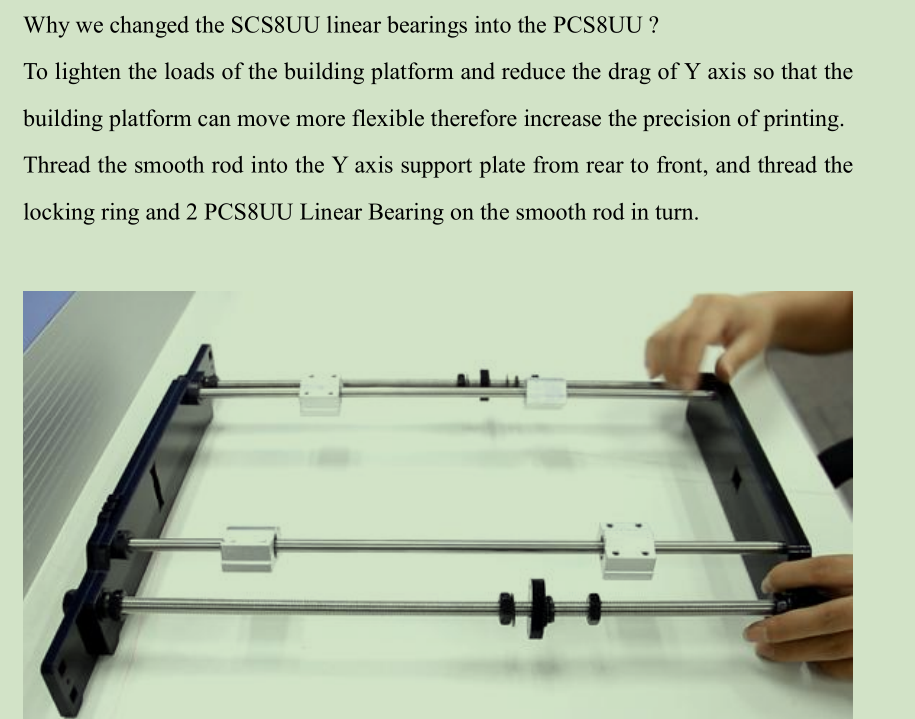

Hi, i've choose the I3 M201 as my first 3d printer but i've some trouble building it. The written instruction and the video on youtube show that the linear bearing is the SCS8UU but in my package i find the PCS8UU and the M4 x 16mm screw go inside the holes of those and in the holes of the building platform support and i can't find how to block them. If anyone can help i'll appreciate it very much, thanks to all
Re: Prusa I3 M201 building problem
Hi,the SCS8UU linear bearings already have been changed into the PCS8UU.PCS8UU linear bearings is a modified version of SCS8UU linear bearings, the block is made of high strength ABS, which is lighter and more flexible.You can find more details in page 8 of the building manual.Please double check it.

thank you very much William
