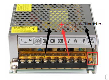

Hi,have you checked the DC output voltage of the PSU with multimeter?It should be 12V when it's normal.And could you post some pictures when the PSU's power is on?
