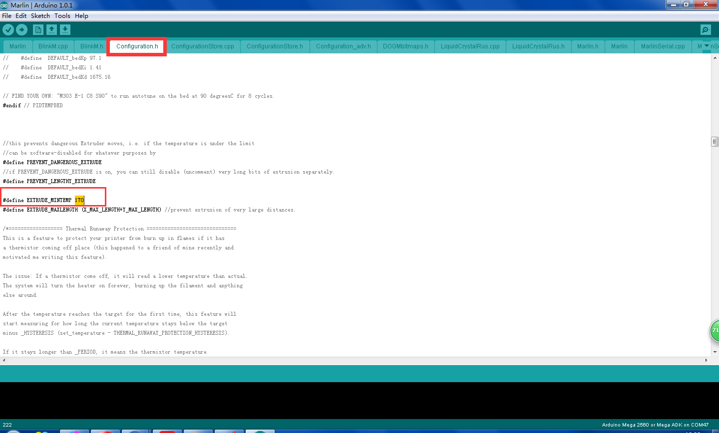

Hi,you can change the related value of firmware to turn this feature off,as shown in this picture.
.Replace 170 with the temperature you need.
