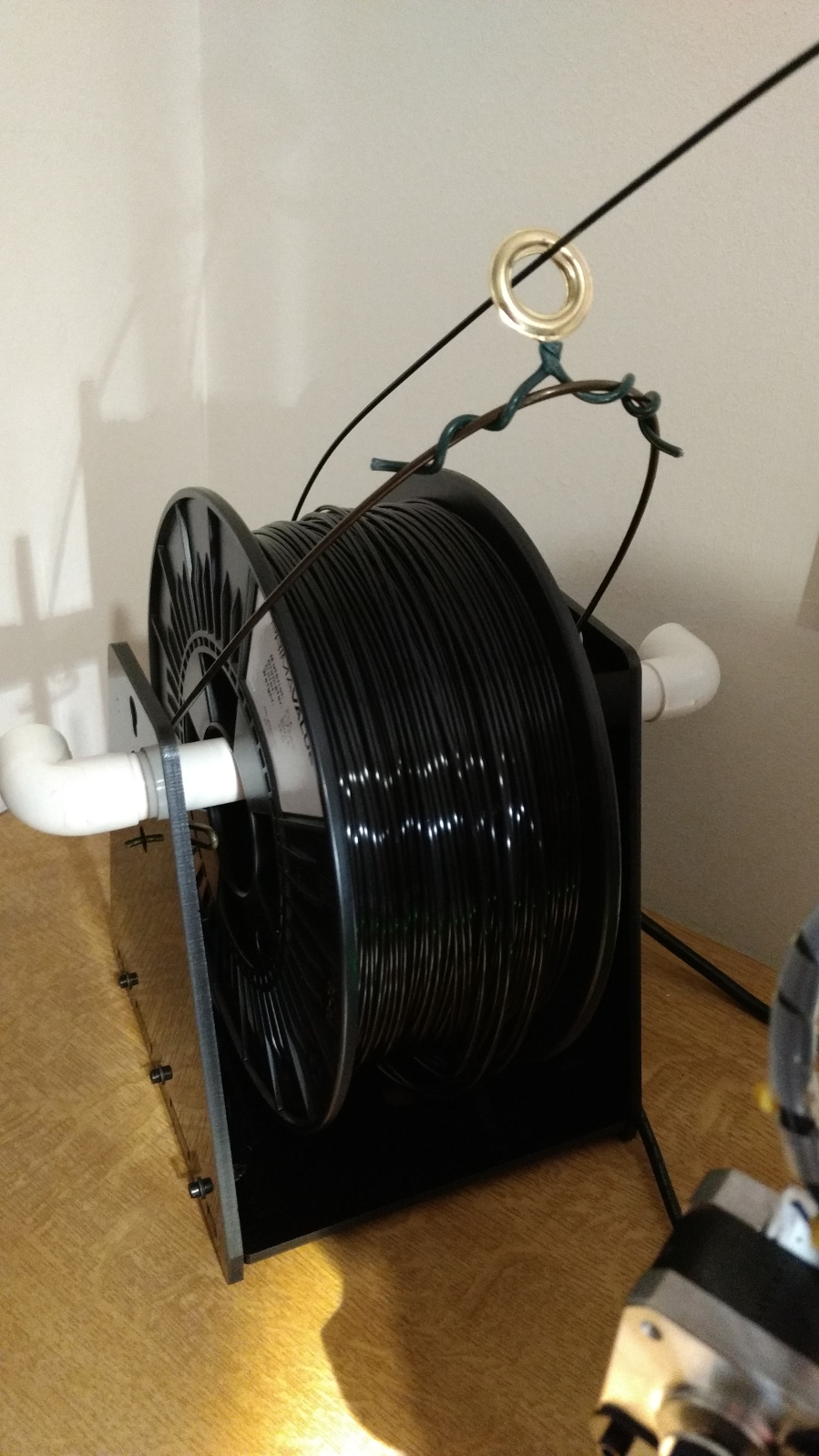

A solution to filament miss-feeding and jamming on the spool:
Spool filament feed mod
I added a bent wire coat hanger, some garden wire and a tarpaulin eyelet to ensure the filament always feeds from the centre of the spool. Works a treat! :)

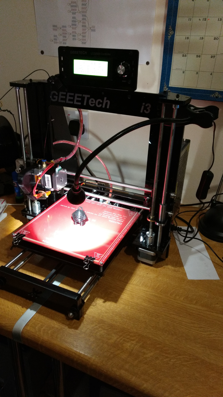

I've also noticed that people have designed and printed ingenious devices to light the hot bed so that the print can be monitored during printing.
I just added an adjustable Ikea LED spotlight, simple, and doesn't look out of place when clipped to the printer. :D
Ikea spotlight addition
This is the Ikea spotlight for those interested.
