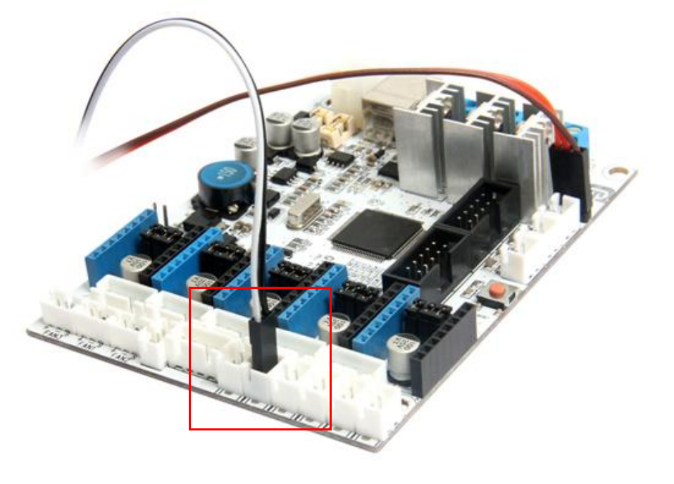

1、Have you checked the 3DTouch's wiring?It should be like the picture showing.
2、Does the printer home normally when remove the sensor?Could you control it through manual control?

I reset my config by default with the Z axis that goes up,
Then we see on the video that I just disconnect the connector (black and white) of the 3d touch and it does the same it goes up
https://www.youtube.com/watch?v=p1pDDbgtB1I
I also did a test off video, if I invert the (black and white) my tray goes down, but the sensor is not working properly because the nozzle comes crushing the tray without stopping ...so I had to Manually stop the printer

Re: BL/ 3D touch officiel not working correctly
I found the problem, I disassemble the sensor, and the white wire was unbolted ...
I solder it, and the sensor works;)
