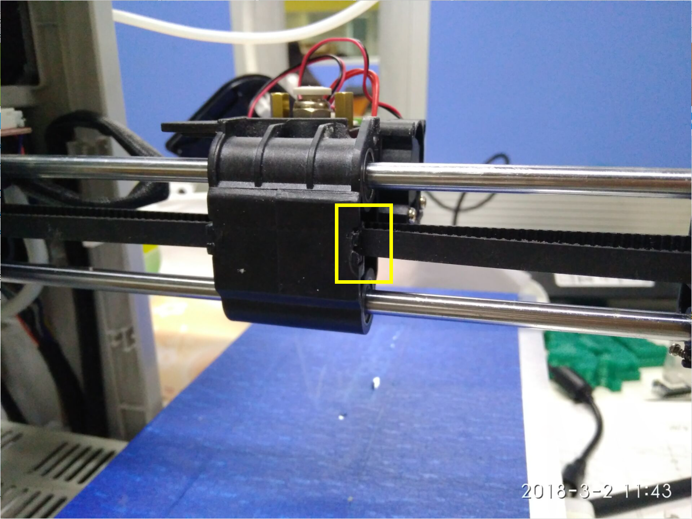

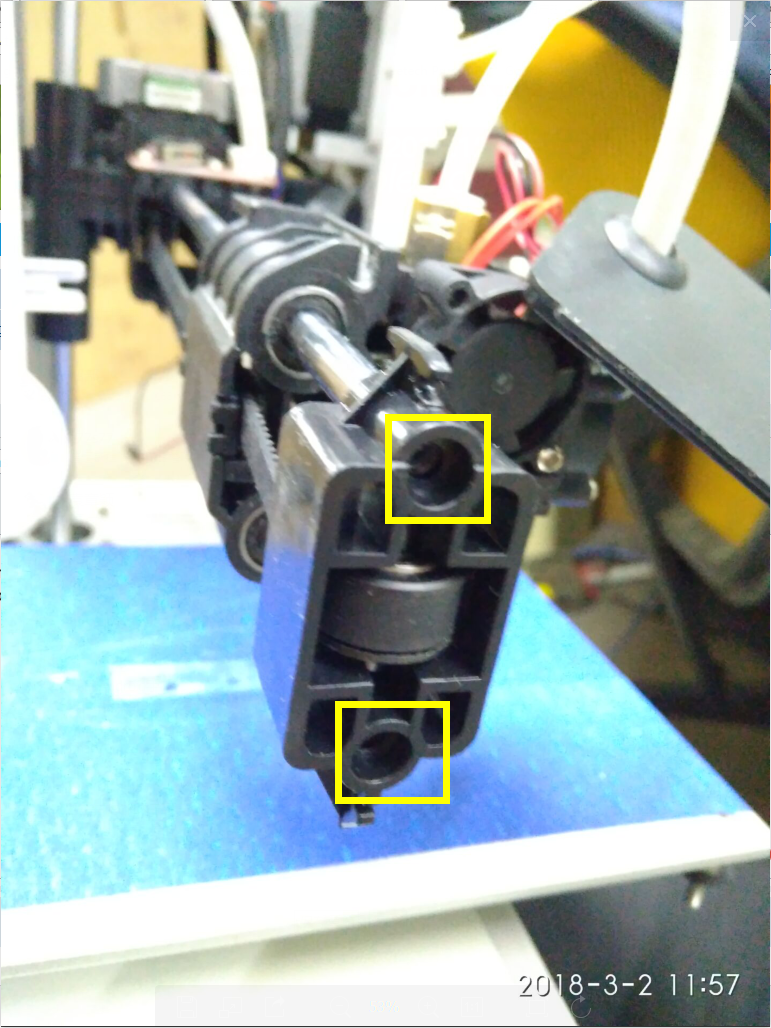

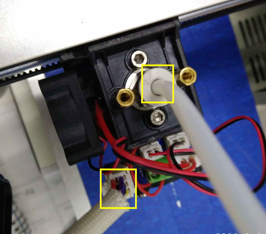

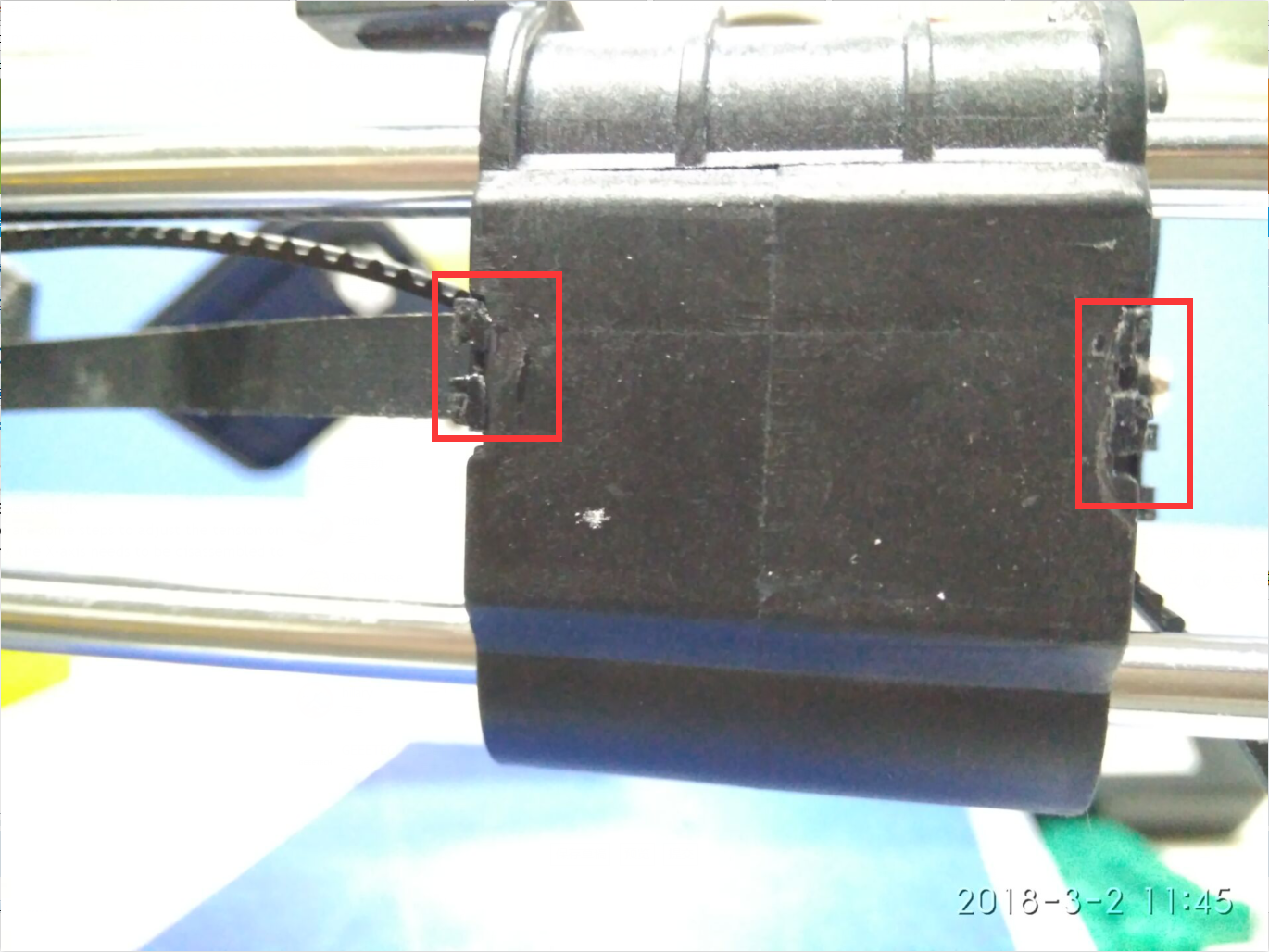

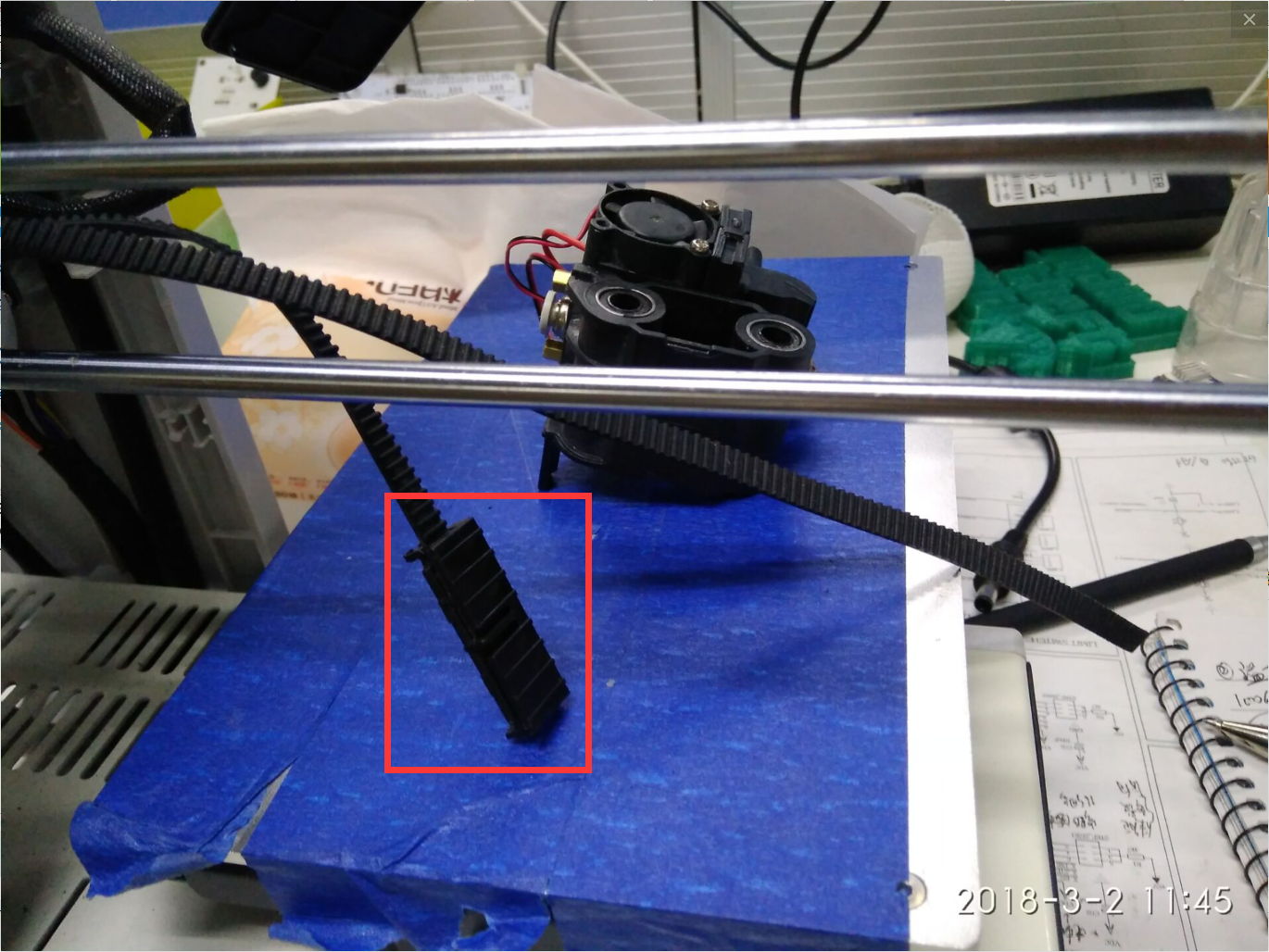

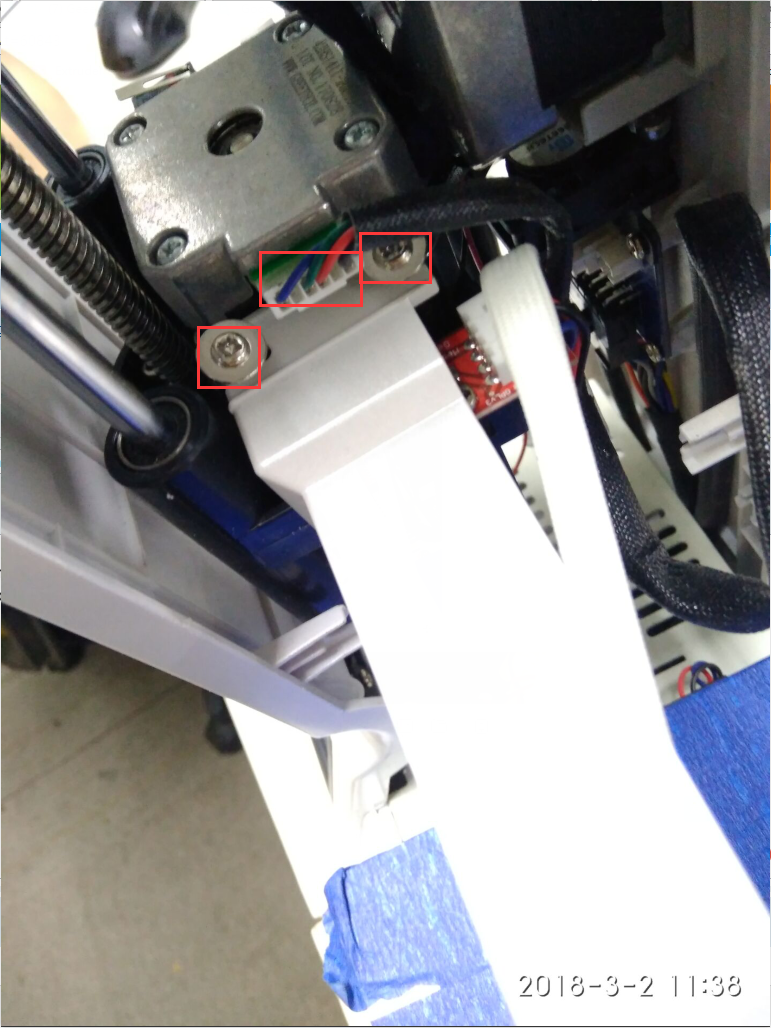

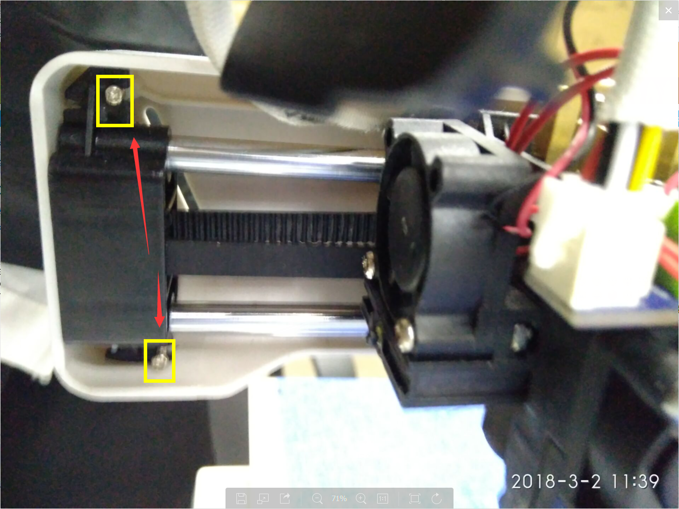

Hi GeeetechUK
Here are some steps to adjust the tension on the x axis
Sorry, the X-axis needs to be disassembled to adjust the belt
1.Remove the motor cable and screws
2.Remove the Teflon tube and extruder cable
3.Refer the pic and remove the screws
4.
5.Remove the belt carefully
6.Clean the glue carefully
7.Then you can remove it off and you can adjust it
