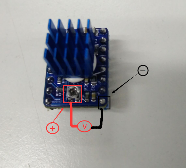

5.Increase the voltage of A4988(extruder motor driver board)-------Blue type:0.6~0.9V
Refer to this post
viewtopic.php?f=19&t=17097 If the issue still on.You can set "factory default"

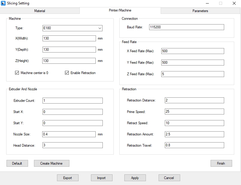

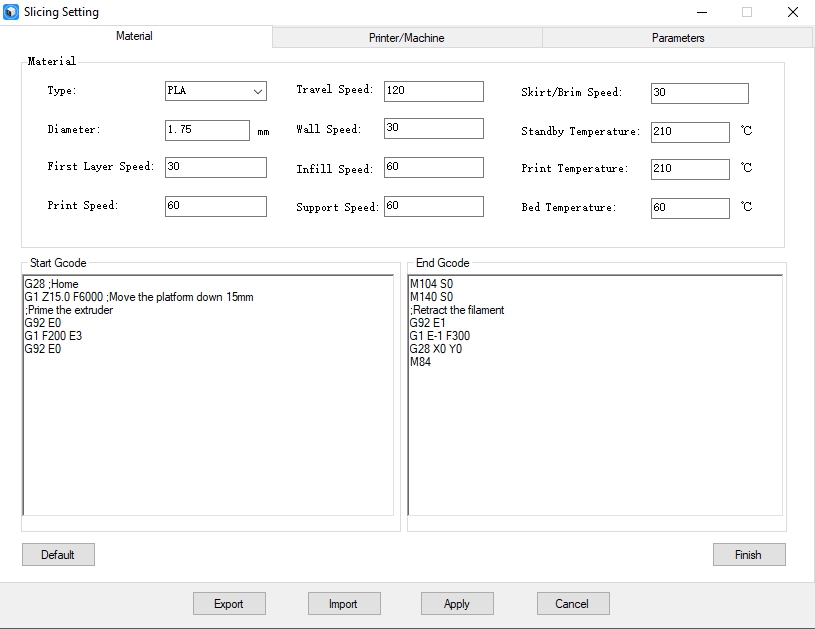

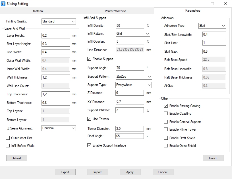

The Settings (see attached Pictures)
1. Heating is anytime 210C - The EasyPrint can set it coincidentally to 175C and then i can emergency stop :(
2. Remove the Teflon Cube - What is that ?
3. The retraction speed is an mystery: the gear on the filament-Input (i don´t know how it names) stucks and the filament came not smooth in the printer. it sounds "knuggling" and the filament springs back some mm and so on while printing.
4. the Temp of the Noozle is already set by 1. (or not) ?
5. i don´t want to disassembly the printer and change any parts of it. i´m user and no engineer.
[attachment=0]EasyPrint 3D Settings3.jpg[/attachment]
[attachment=1]EasyPrint 3D Settings2.jpg[/attachment]
[attachment=2]EasyPrint 3D Settings1.jpg[/attachment]

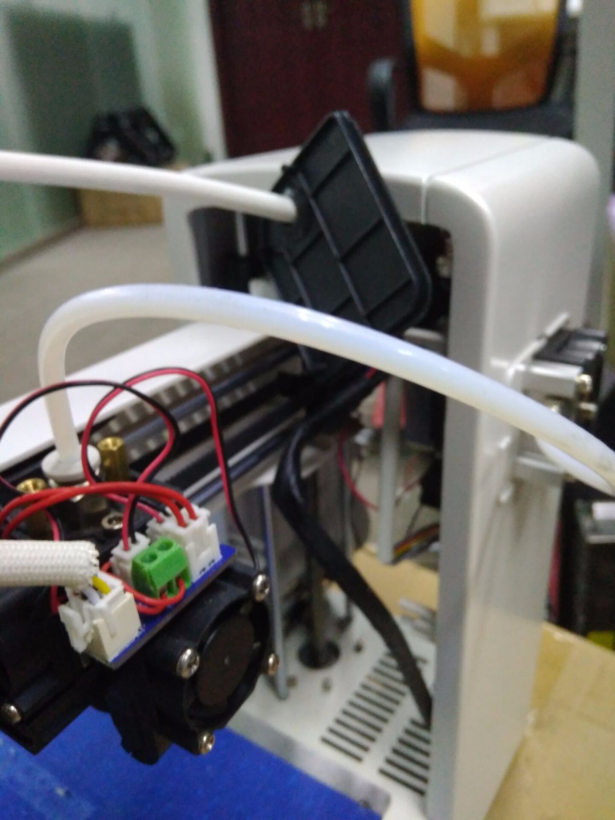

Re: Problems while printing
It is my fault>>I mean it is Teflon tube
Replace it with another nozzle
Hello!
The Tube is okay (clear and well formed). Please can you take a look of my EasyPrint3D Settings ? I will know that the settings perfect!
thank you
thank you
Settings okay.
