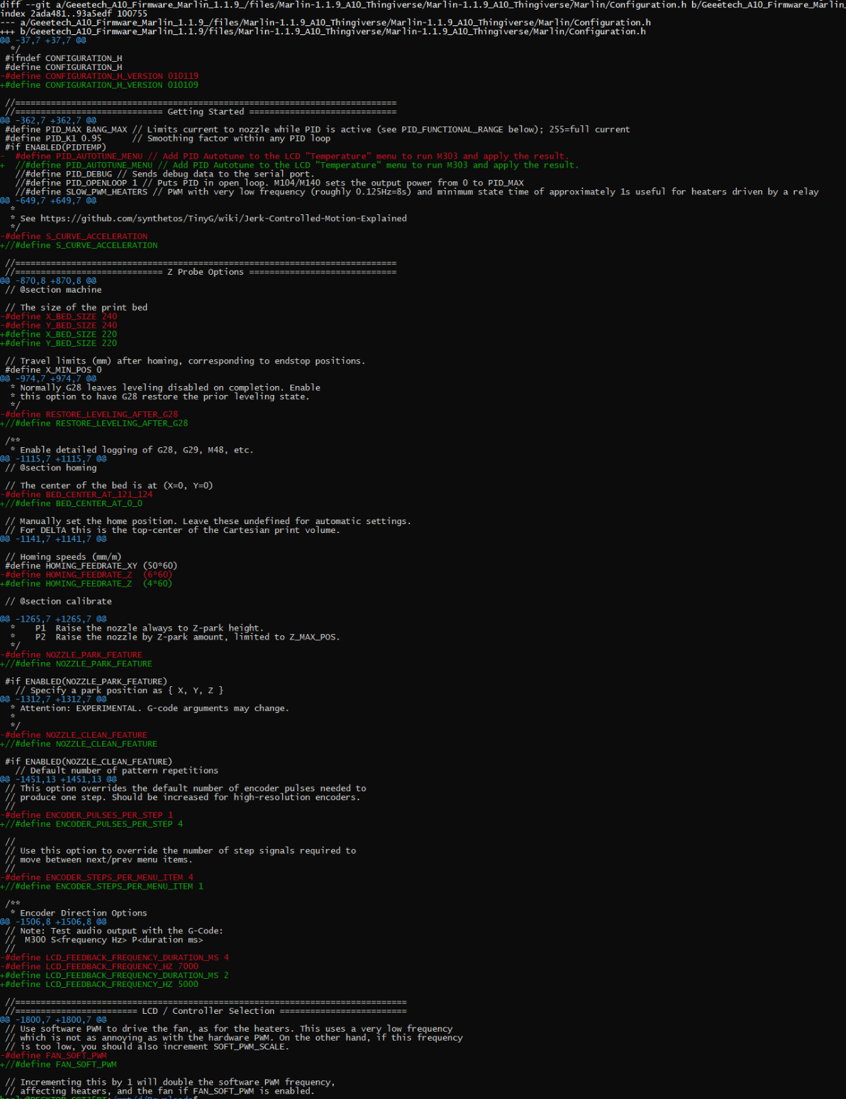

Below is the main diffs from your builds.
For better readability I'm appending the same diffs as colorised diff output screenshots. Red are my changes on your configs, which are green.
My main flow for working with this printer is: PC with Cura talk via WiFi to Cura Server running on Raspberry PI3, which in another room is connected to the printer. For firmware upgrades I just use Cura Server's web interface and upload from there and that would bve all.. Easy...
I'm now going to figure out the simplest way to start controlling both controller's extruder's cooling fan, as these 2 fans are the noisiest and really annoying, especially when printer is idle - there's no need for them to be spinning at max rpm!
Marlin-1.1.9-aarli-mod.conf.zip
Configuration.h and Configuration_Adv.h themselves
(45.02 KiB) Downloaded 990 times
Configuration_Adv.h diff screenshot
Configuration.h diff screenshot
