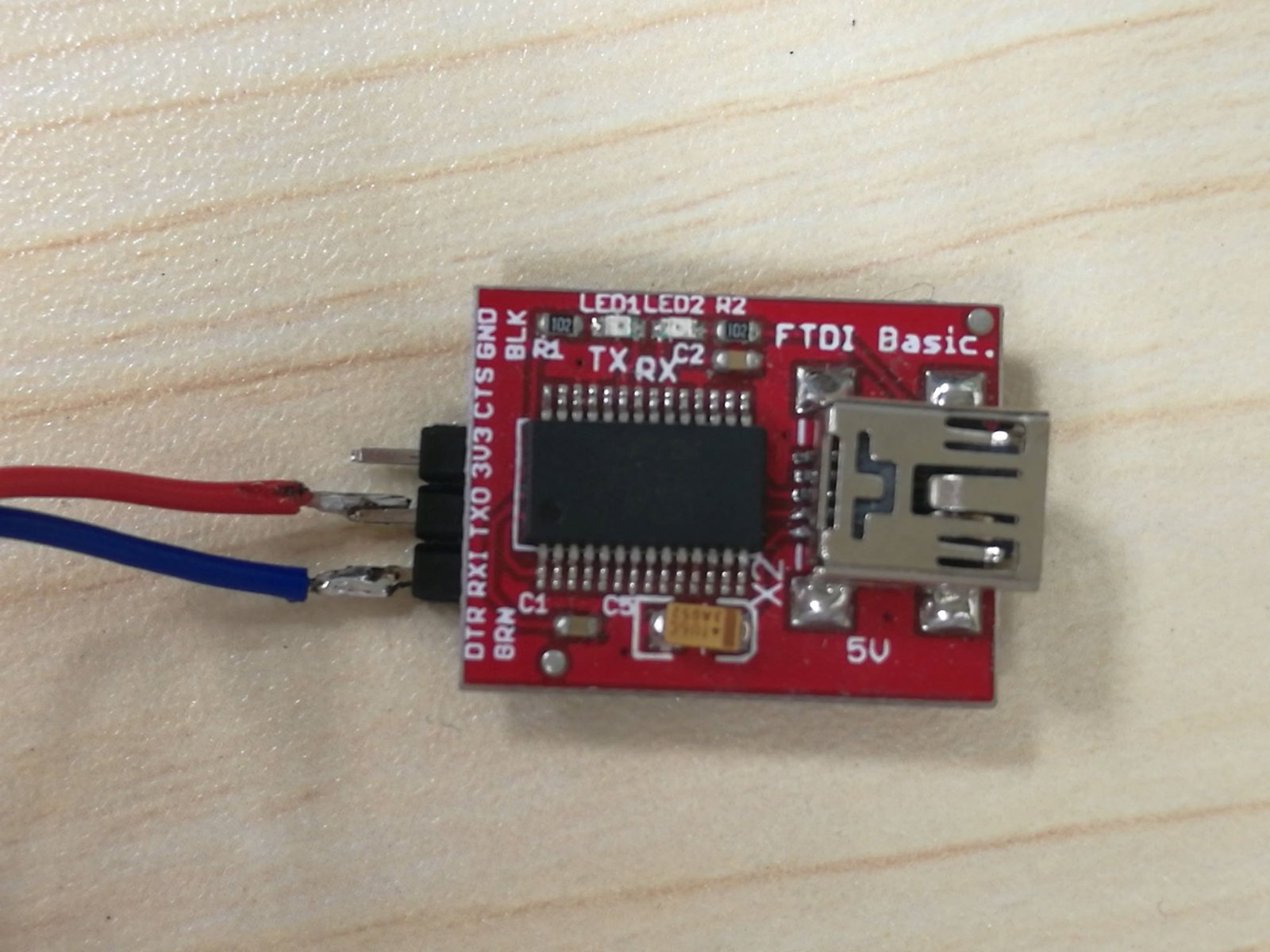

  • any USB converter <-> RS232 TTL,

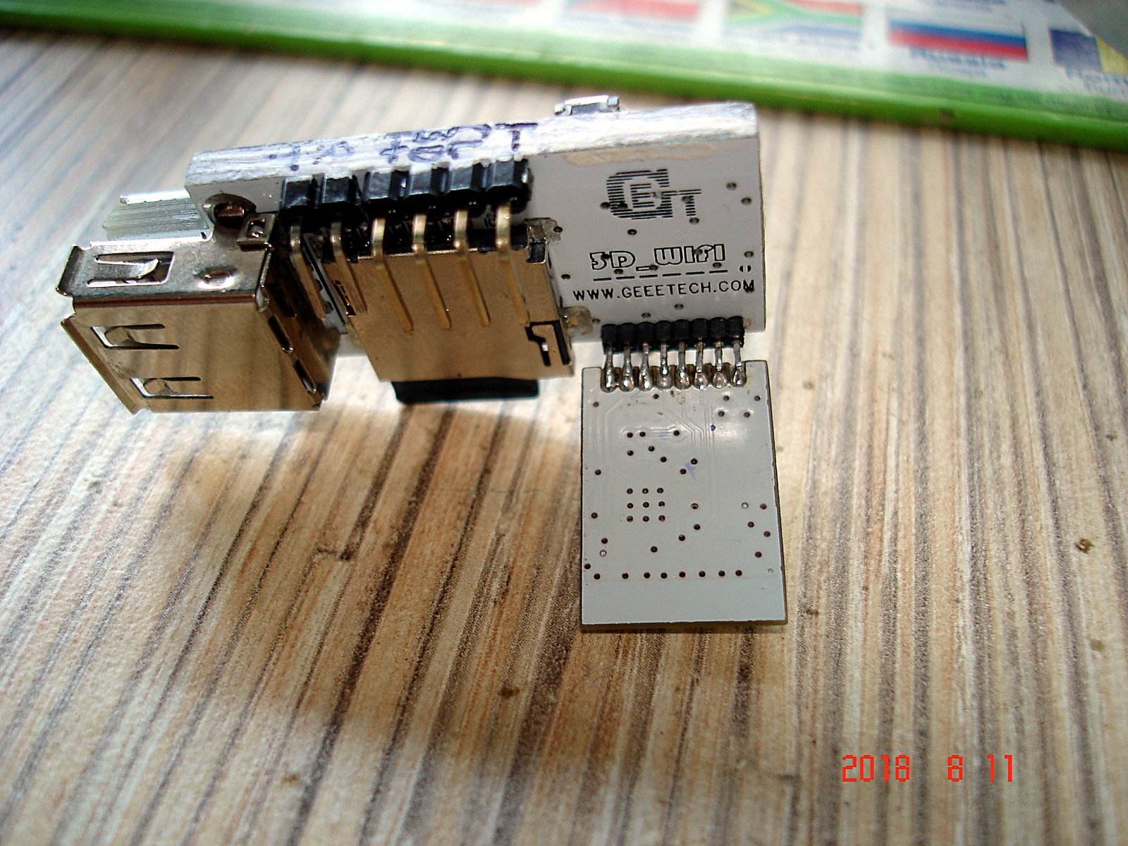

  2. Solder the gold pin to the pads of the module.

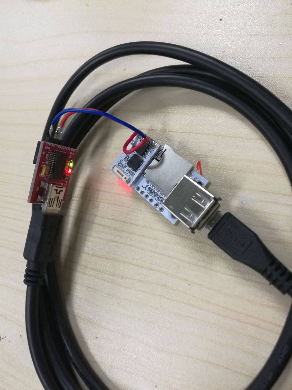

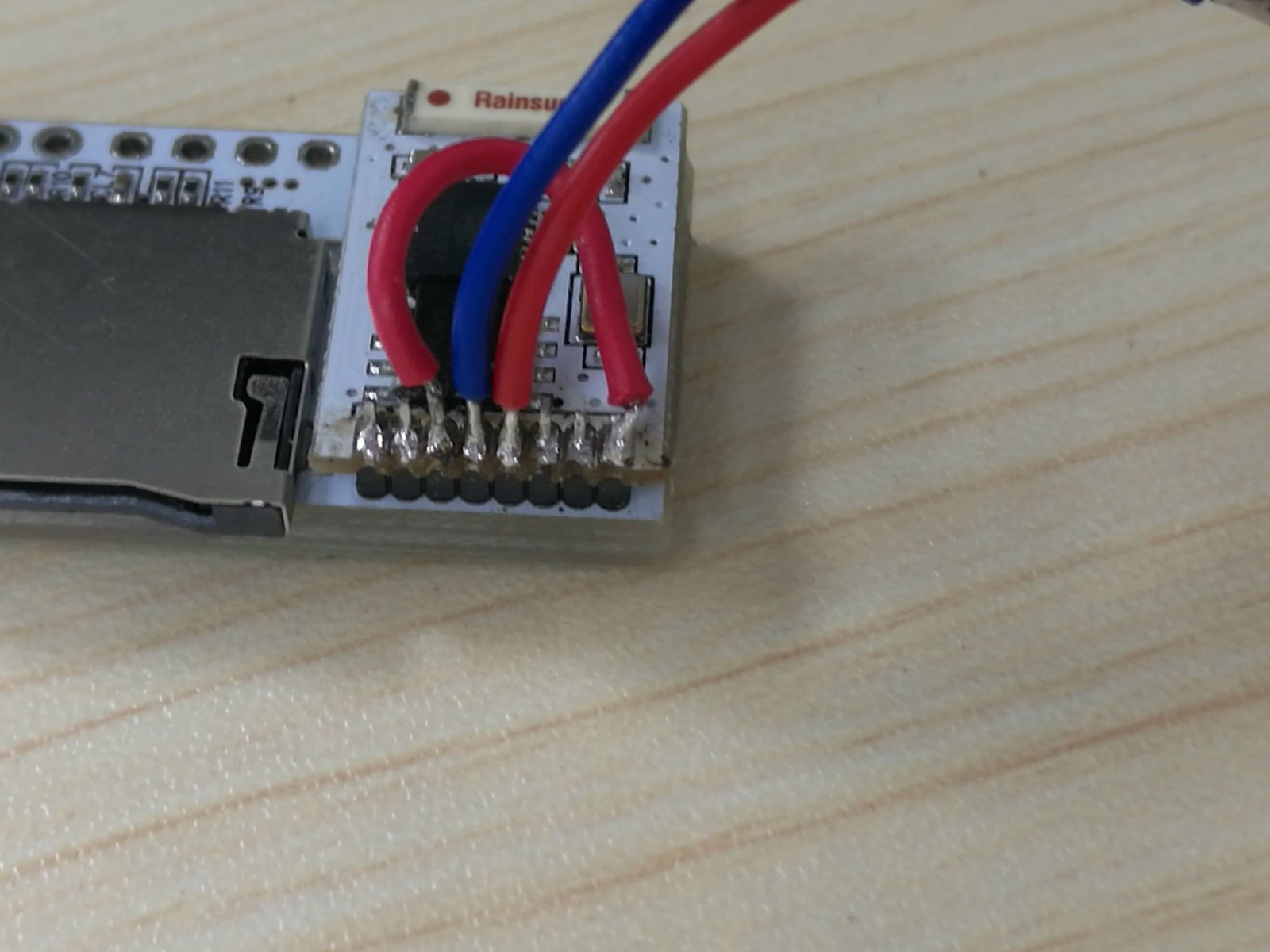

  4. Solder the necessary wires to the ESP module connector. RxD, TxD. GPIO0 pin should be connected to GND. It is also worth to prepare additional cable from one side soldered to GND. It may be necessary to restart the ESP module manually.

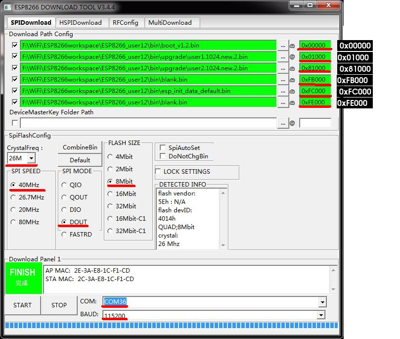

  5. Upload firmware for the ESP module. All software is divided into parts, files:
    blank.bin, boot_v1.2.bin, esp_init_data_default.bin, user1.1.2.2.bin, user2.1.2.22.bin
    If there are problems with synchronization after starting the programming process, the module can be restarted manually. We will do this by touching the end of the cable with GDN potential to the RESET lead of the ESP module.

One remark. If someone uses power from a USB <-> RS232 adapter, he must remember that the performance of this power source is relatively small - about 50mA. This is far too little to carry out tests of the device's functioning.
Minimum - recommended current efficiency of the PSU is 500mA.
The power supply from the adapter is sufficient for the programming. When the ESP module is set to firmware loading mode, it consumes about 40mA of current.

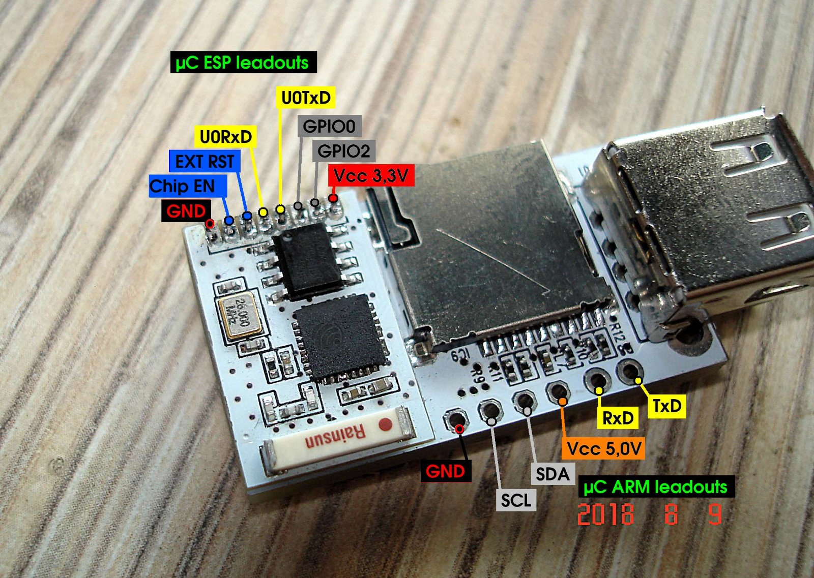

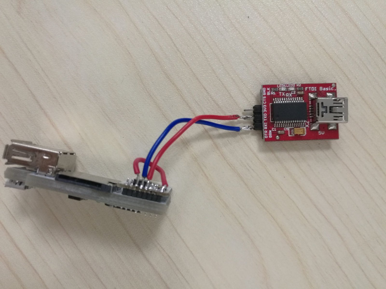

Helpful photos and screenshots:
circuit leads:
[/size]
Leadouts.
Leadouts.
configuring the "ESP8266 DOWNLOAD TOOL" utility.
Configuring the ESP utility.

A kaktus module.
A kaktus module.
a module perfectly prepared to start the migration.
A Tingjian module.
A Tingjian module.

esptool write_flash --flash_mode dout --flash_size 1MB 0x0 boot_v1.2.bin 0x1000 user1.1.2.2.bin 0x81000 user2.1.2.22.bin 0xFB000 blank.bin 0xFC000 esp_init_data_default.bin 0xFE000 blank.bin
